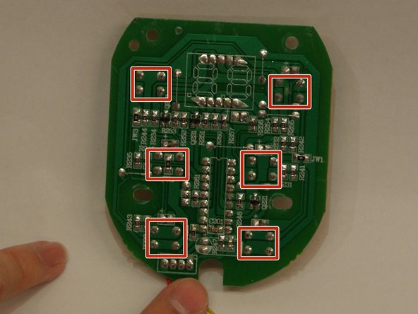

  11. Aroma ARC-914SBD Push Buttons Replacement, Push Buttons: crwdns2935265:011crwdnd2935265:01crwdnd2935265:02crwdne2935265:0 Aroma ARC-914SBD Push Buttons Replacement, Push Buttons: crwdns2935265:011crwdnd2935265:02crwdnd2935265:02crwdne2935265:0
    • These pictures identify the Push Buttons along with their corresponding solder points through the back of the circuit board.
  12. Aroma ARC-914SBD Push Buttons Replacement: crwdns2935265:012crwdnd2935265:01crwdnd2935265:01crwdne2935265:0
    • Heat each point with the soldering iron while pulling the Push Button out from the front in order to remove the buttons.
