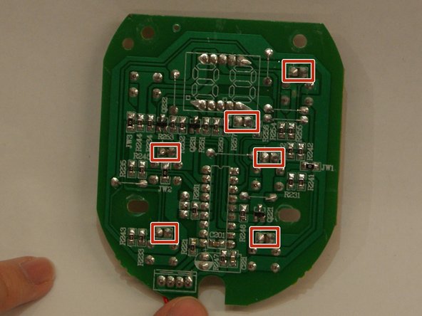

  11. Aroma ARC-914SBD LED Lights Replacement, LED Lights: crwdns2935265:011crwdnd2935265:01crwdnd2935265:02crwdne2935265:0 Aroma ARC-914SBD LED Lights Replacement, LED Lights: crwdns2935265:011crwdnd2935265:02crwdnd2935265:02crwdne2935265:0
    • These pictures identify the LED's along with their corresponding solder points through the back of the circuit board.
  12. Aroma ARC-914SBD LED Lights Replacement: crwdns2935265:012crwdnd2935265:01crwdnd2935265:01crwdne2935265:0
    • Heat each point with the soldering iron while pulling the LED out from the front in order to remove the lights. The arrow in the picture points to the + sign above the left solder point. Each of the LED solder points will have one. LED's are polarity sensitive; therefore, the positive pin on the new LED must match up to the positive solder point.
