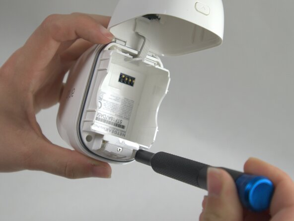

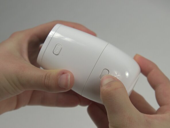

    • Press the release button on the camera and gently pull apart the casing to open the device.
    • Remove the battery from inside the case.
  2. Arlo Pro 2 Camera Lens Replacement: crwdns2935265:02crwdnd2935265:01crwdnd2935265:03crwdne2935265:0 Arlo Pro 2 Camera Lens Replacement: crwdns2935265:02crwdnd2935265:02crwdnd2935265:03crwdne2935265:0 Arlo Pro 2 Camera Lens Replacement: crwdns2935265:02crwdnd2935265:03crwdnd2935265:03crwdne2935265:0

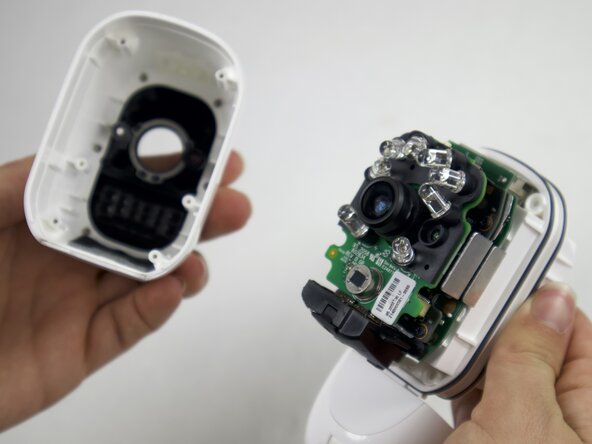

    • Use a T5 Torx screwdriver to remove the four 7 mm screws securing the camera case.
    • Carefully pull the outside of the case apart from the internal case to remove the camera components from the outside casing.

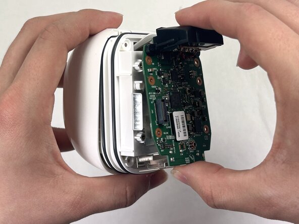

  3. Arlo Pro 2 Camera Lens Replacement: crwdns2935265:03crwdnd2935265:01crwdnd2935265:03crwdne2935265:0 Arlo Pro 2 Camera Lens Replacement: crwdns2935265:03crwdnd2935265:02crwdnd2935265:03crwdne2935265:0 Arlo Pro 2 Camera Lens Replacement: crwdns2935265:03crwdnd2935265:03crwdnd2935265:03crwdne2935265:0

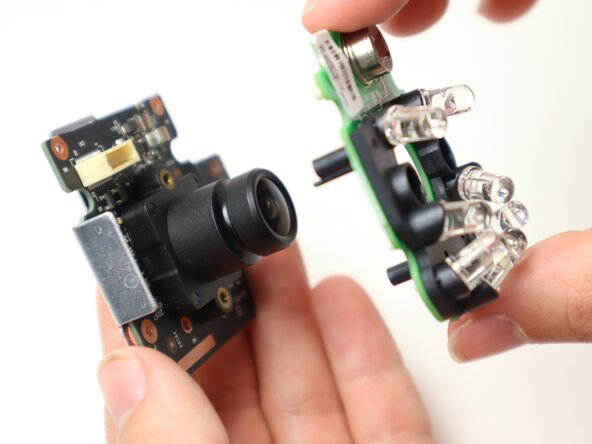

    • Use a Phillips #00 screwdriver to remove four 4 mm screws connecting the daughterboards to the motherboard.
    • Seperate the daughterboards from the motherboard and camera casing.

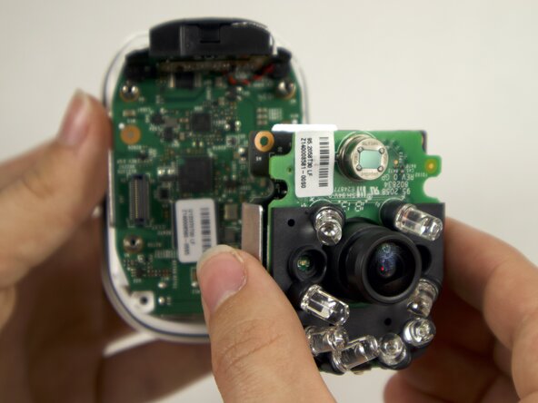

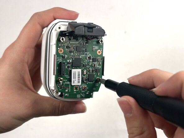

  4. Arlo Pro 2 Camera Lens Replacement: crwdns2935265:04crwdnd2935265:01crwdnd2935265:03crwdne2935265:0 Arlo Pro 2 Camera Lens Replacement: crwdns2935265:04crwdnd2935265:02crwdnd2935265:03crwdne2935265:0 Arlo Pro 2 Camera Lens Replacement: crwdns2935265:04crwdnd2935265:03crwdnd2935265:03crwdne2935265:0

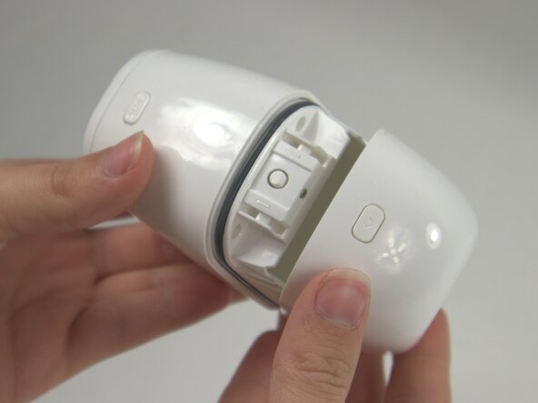

    • Use a Flathead 4 mm screwdriver to remove the four 7 mm screw posts connecting the motherboard to the case.
    • Carefully pull the motherboard apart from the camera casing.

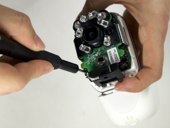

  5. Arlo Pro 2 Camera Lens Replacement: crwdns2935265:05crwdnd2935265:01crwdnd2935265:02crwdne2935265:0 Arlo Pro 2 Camera Lens Replacement: crwdns2935265:05crwdnd2935265:02crwdnd2935265:02crwdne2935265:0

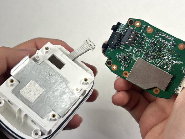

    • Disconnect the white cord from the port on the motherboard, by gently pulling away from the port to fully isolate the motherboard from the case.

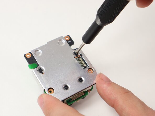

  6. Arlo Pro 2 Camera Lens Replacement, Camera Lens: crwdns2935265:06crwdnd2935265:01crwdnd2935265:02crwdne2935265:0 Arlo Pro 2 Camera Lens Replacement, Camera Lens: crwdns2935265:06crwdnd2935265:02crwdnd2935265:02crwdne2935265:0

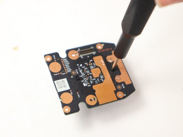

    • Use a Philips #00 screwdriver to remove the four 4 mm screws on the back metal plate holding the daughterboards together.

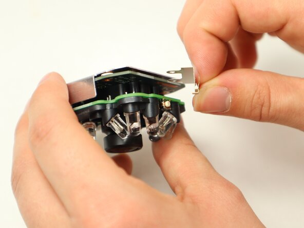

  7. Arlo Pro 2 Camera Lens Replacement: crwdns2935265:07crwdnd2935265:01crwdnd2935265:02crwdne2935265:0 Arlo Pro 2 Camera Lens Replacement: crwdns2935265:07crwdnd2935265:02crwdnd2935265:02crwdne2935265:0
    • Slide out a small metal retainer bracket from in between the daughterboards.

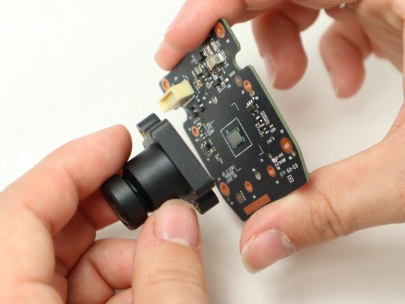

  10. Arlo Pro 2 Camera Lens Replacement: crwdns2935265:010crwdnd2935265:01crwdnd2935265:03crwdne2935265:0 Arlo Pro 2 Camera Lens Replacement: crwdns2935265:010crwdnd2935265:02crwdnd2935265:03crwdne2935265:0 Arlo Pro 2 Camera Lens Replacement: crwdns2935265:010crwdnd2935265:03crwdnd2935265:03crwdne2935265:0
    • Use a Philips #00 screwdriver to remove the two 5 mm screws on the back of the camera daughterboard to disconnect the camera piece from the daughterboard.
