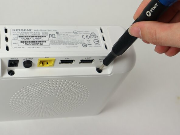

    • Use a TR10 Torx screwdriver to remove the two 10 mm screws on the side of the base station, above the USB ports.

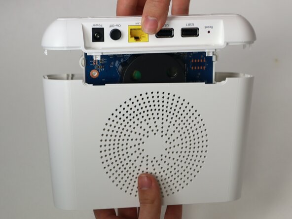

    • Pull apart the top case from the bottom.
    • This may require some force as there are internal catches.

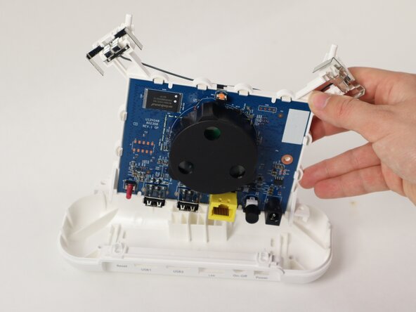

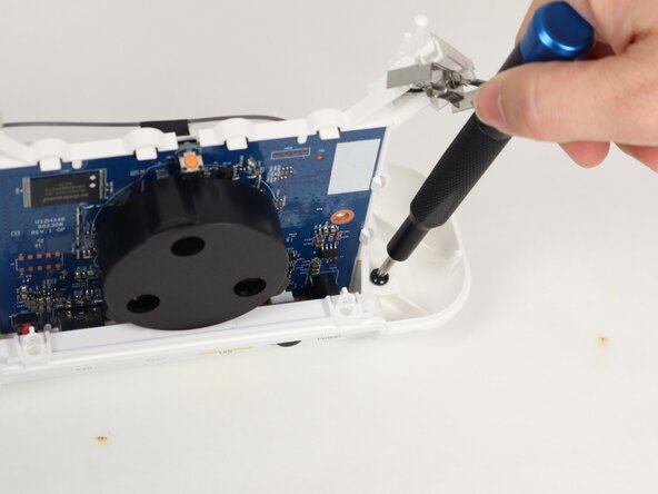

    • Use a TR10 Torx screwdriver to remove the two 10 mm screws to disconnect the motherboard from the base casing.
    • The motherboard is connected to the USB ports; when removing it be careful to gently remove the USB ports from their cavities to avoid any damage.
