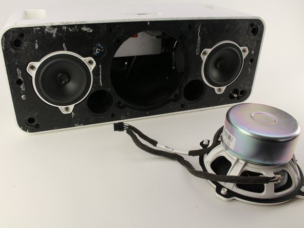

  5. Apple iPod Hi-Fi Front Panel and Speaker Connections Replacement: crwdns2935265:05crwdnd2935265:01crwdnd2935265:02crwdne2935265:0 Apple iPod Hi-Fi Front Panel and Speaker Connections Replacement: crwdns2935265:05crwdnd2935265:02crwdnd2935265:02crwdne2935265:0
    • Pry out the large speaker with a metal spudger around the edge.
    • Remove the speaker slowly from its socket with your hands.
    • Turning the speaker on its side will make this step much easier.
    • The speaker is still attached by several connections at this point so the speaker will not be able to be removed completely at this step.
  6. Apple iPod Hi-Fi Front Panel and Speaker Connections Replacement: crwdns2935265:06crwdnd2935265:01crwdnd2935265:02crwdne2935265:0 Apple iPod Hi-Fi Front Panel and Speaker Connections Replacement: crwdns2935265:06crwdnd2935265:02crwdnd2935265:02crwdne2935265:0
    • Press down on the tab and pull out with your hands to remove the cable connecting the large speaker from the rest of the unit.
    • Pull the large speaker completely out and set aside.

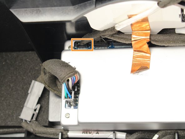

  7. Apple iPod Hi-Fi Front Panel and Speaker Connections Replacement: crwdns2935265:07crwdnd2935265:01crwdnd2935265:01crwdne2935265:0
    • Remove the sensor connection by pulling it straight out with your hand.

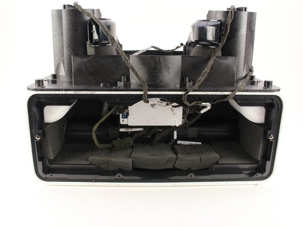

  8. Apple iPod Hi-Fi Front Panel and Speaker Connections Replacement: crwdns2935265:08crwdnd2935265:01crwdnd2935265:03crwdne2935265:0 Apple iPod Hi-Fi Front Panel and Speaker Connections Replacement: crwdns2935265:08crwdnd2935265:02crwdnd2935265:03crwdne2935265:0 Apple iPod Hi-Fi Front Panel and Speaker Connections Replacement: crwdns2935265:08crwdnd2935265:03crwdnd2935265:03crwdne2935265:0
    • Pull the entire front assembly off by prying it up with the spudger and lifting the assembly off with your hands towards the top of the Hi-Fi.
    • There are still connections attached at this stage so the front assembly will not completely disconnect from the rest of the device .

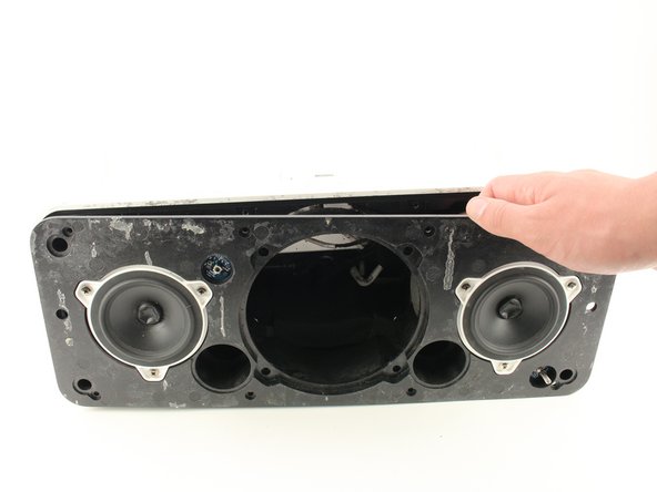

  9. Apple iPod Hi-Fi Front Panel and Speaker Connections Replacement: crwdns2935265:09crwdnd2935265:01crwdnd2935265:02crwdne2935265:0 Apple iPod Hi-Fi Front Panel and Speaker Connections Replacement: crwdns2935265:09crwdnd2935265:02crwdnd2935265:02crwdne2935265:0
    • Remove the clips for the remaining two speakers by repeating step 6.
    • Remove the last connection that connects the speakers to the power box.
    • Remove the front panel completely.
    • When reassembling, the ports are labeled "right" and "left" to help you plug in the right speaker to the right port.
