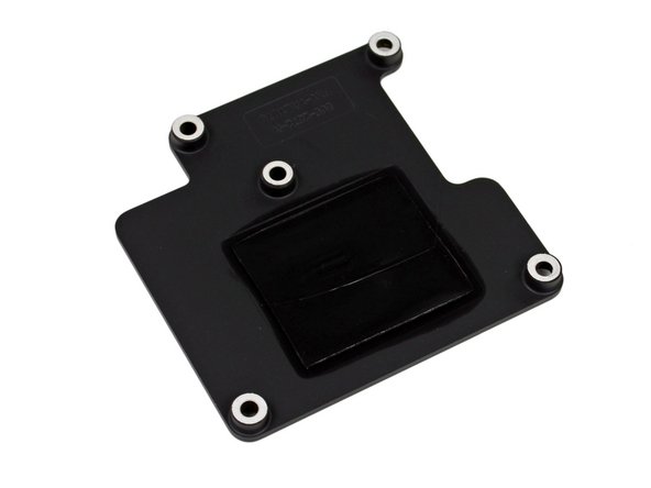

  3. Apple TV 3rd Generation Teardown: crwdns2935265:03crwdnd2935265:01crwdnd2935265:02crwdne2935265:0 Apple TV 3rd Generation Teardown: crwdns2935265:03crwdnd2935265:02crwdnd2935265:02crwdne2935265:0
    • A quick turn of our screwdriver frees the metal heat sink.
    • Under the metal heat sink resides a small thermal plate, just like in the previous generation.

So I decided to teardown my 3rd Gen Apple TV just out of curiosity, and when I managed to finally open it, my unit is missing a Heat Sink, all that is there is the silver thermal plate. Is this a bad thing or does it not matter much? Maybe it was an error in the manufacturing process.
Lian Silveira - crwdns2934203:0crwdne2934203:0
I had the same thing happen to me when I opened mine up. The bottom lid was discolored around the I/O ports as well. It did not come off when I tried to clean it. It almost looks like the metal was hot and slightly melted the plastic bottom.
Tomas Del Toro -
