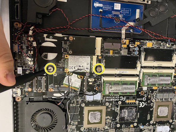

    • Use the Phillips #0 Screwdriver to remove the two screws holding the mSATA.
    • With a gently tug, disconnect the four white plugs.
    • Use the Phillips #0 Screwdriver to remove the two screws holding the wireless card.

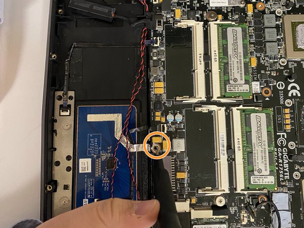

    • Use the Phillips #0 Screwdriver to remove the three screws on the left speaker.
    • Lift the motherboard slightly near the parallel speaker screws to find the orange ribbon underneath. Use the Blunt Nose Tweezer to gently pull it off.
    • In the same area as the blue ribbon, find the orange ribbon and gently pull it off using a pair of needle nose pliers for access to remove the motherboard.
