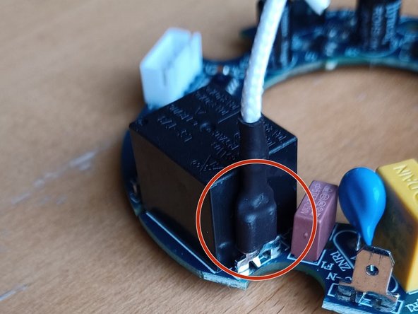

  2. Anko Milk Frother SB-0802C1 Teardown, Undo the power connections: crwdns2935265:02crwdnd2935265:01crwdnd2935265:03crwdne2935265:0 Anko Milk Frother SB-0802C1 Teardown, Undo the power connections: crwdns2935265:02crwdnd2935265:02crwdnd2935265:03crwdne2935265:0 Anko Milk Frother SB-0802C1 Teardown, Undo the power connections: crwdns2935265:02crwdnd2935265:03crwdnd2935265:03crwdne2935265:0
    • There are 5 spade connectors providing power from the bottom assembly to the PCB, and from the PCB to the heating element.
    • These connectors have a release latch hidden under their heat shrink. You may see a little bulge. You need to depress this latch before you can pull the spade connector off.

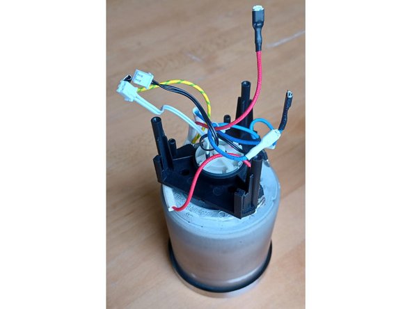

  3. Anko Milk Frother SB-0802C1 Teardown, Slide the milk container out of the shell: crwdns2935265:03crwdnd2935265:01crwdnd2935265:02crwdne2935265:0 Anko Milk Frother SB-0802C1 Teardown, Slide the milk container out of the shell: crwdns2935265:03crwdnd2935265:02crwdnd2935265:02crwdne2935265:0
    • NOTE - When these last connections are removed, there is nothing stopping the heavier milk container assembly to slide out of the outer shell.
    • So before you move on to the next step, make sure to hold on to the milk container assembly.

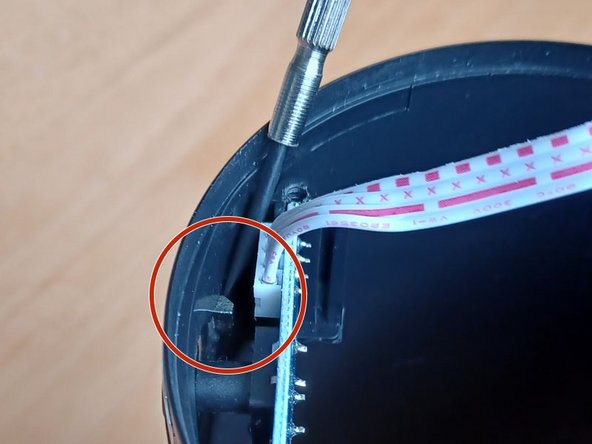

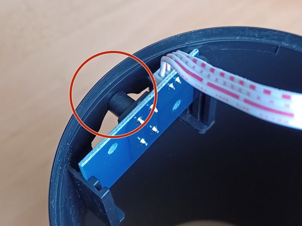

  6. Anko Milk Frother SB-0802C1 Teardown, Separate the Button PCB from the outer shell: crwdns2935265:06crwdnd2935265:01crwdnd2935265:03crwdne2935265:0 Anko Milk Frother SB-0802C1 Teardown, Separate the Button PCB from the outer shell: crwdns2935265:06crwdnd2935265:02crwdnd2935265:03crwdne2935265:0 Anko Milk Frother SB-0802C1 Teardown, Separate the Button PCB from the outer shell: crwdns2935265:06crwdnd2935265:03crwdnd2935265:03crwdne2935265:0
    • Remove the screw that's holding the PCB in place.
    • Use a small screwdriver to push the click finger in. Then remove the plastic button ring and silicon rubber seal.
    • Depress the button and slide the PCB out of its guides.
