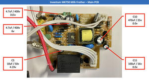

Checking the PCB I have found 5 elco's.
I have measured their voltage with power to the board, and the detection switch switched on. You can find the measurements in the attached picture.
In the upper left corner there are two same type capacitors (4.7uF/400v). One reads 1v and the other one reads '-1' in the display of my multimeter.
# Could that be the broken one?
# What do you think?

It may be the polyester capacitor the does the voltage drop for powering the electronics. There will be a 10-100uF, 25-50 capacitor somewhere. Check to see if there is a voltage across it. If not check or replace the polyester capacitor.

Thnx Alan!
In the upper left corner there are two same type capacitors (4.7uF/400v). One reads 6v and the other one reads 315v on the multimeter.
Question
  • What do you think?
In the meantime, I have replaced most of the capacitors.
On the main PCB:
  • 2x 4.7uF / 400v
  • 1x 10uF / 50v
  • 1x 100uF / 16v
The 470uF / 25v has not been replaced, as I did not have that one available.
On the button PCB:
  • 1x 100uF / 16v
Result:
Unfortunately no difference. Still no response to powering up, no LED activity.
Consideration:
Since there is no information available, especially not about the PCB/schematics, it's a bit of guessing. So far I have replaced the relay, and most capacitors. But with no result. Both fuses measure continuity, all switches work and the heating element also seems ok.
Checking the components on both PCB's visually, there are none that show damage or any other look than normal.
What's left are transistors and IC's.
Question:
Any advice on my next step?
