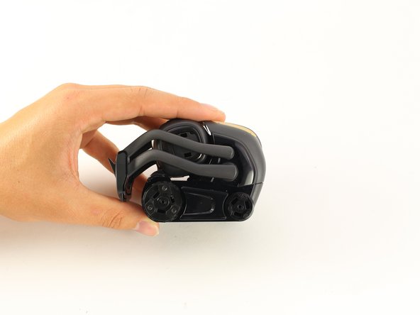

    • Raise Vector's arms above his head.
  2. Anki Vector  Capacitive Touch Sensor Replacement: crwdns2935265:02crwdnd2935265:01crwdnd2935265:02crwdne2935265:0 Anki Vector  Capacitive Touch Sensor Replacement: crwdns2935265:02crwdnd2935265:02crwdnd2935265:02crwdne2935265:0
    • Using your thumb and index finger, grab the lower portion of the belt near the large wheel and pull the belt off.
    • Repeat on the other side.

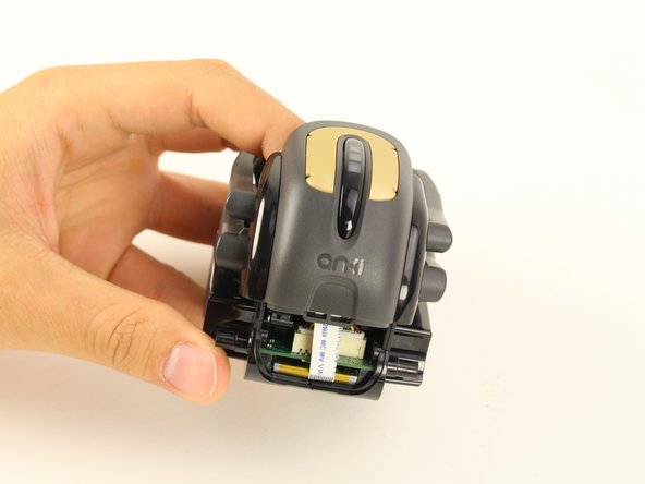

    • Gently remove the rear panel by griping it towards the top and pulling out and up.
    • Gently pull out the ribbon cable from the plug between the motherboard and the weight.

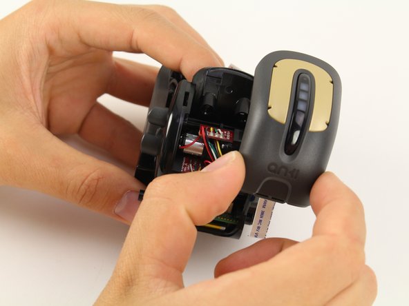

    • Using a Phillips #0 screwdriver, unscrew the two screws located behind Vector's neck.
    • Lift the capacitive touch sensor assembly off of the body
