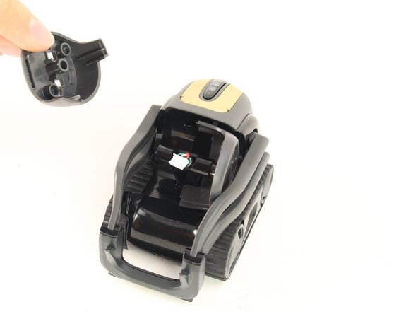

    2. Anki Vector  Battery Replacement: crwdns2935265:02crwdnd2935265:01crwdnd2935265:03crwdne2935265:0 Anki Vector  Battery Replacement: crwdns2935265:02crwdnd2935265:02crwdnd2935265:03crwdne2935265:0 Anki Vector  Battery Replacement: crwdns2935265:02crwdnd2935265:03crwdnd2935265:03crwdne2935265:0
      • Insert the corner of the square end of the spudger under the side plate above the partially visible screw.
      • Lightly turn the spudger to separate the plate from Vector's head.
      • Work the spudger around the plate until it comes off.
      • Repeat this step on the the other side.

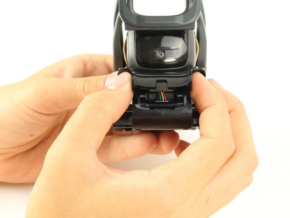

    5. Anki Vector  Battery Replacement: crwdns2935265:05crwdnd2935265:01crwdnd2935265:03crwdne2935265:0 Anki Vector  Battery Replacement: crwdns2935265:05crwdnd2935265:02crwdnd2935265:03crwdne2935265:0 Anki Vector  Battery Replacement: crwdns2935265:05crwdnd2935265:03crwdnd2935265:03crwdne2935265:0
      • Using your thumb and index finger, unplug the display from the plug in Vector's neck.
      • Pull the LCD and speaker assembly from Vector's head.

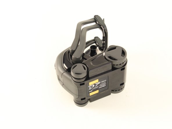

    2. Anki Vector  Battery Replacement: crwdns2935265:07crwdnd2935265:01crwdnd2935265:03crwdne2935265:0 Anki Vector  Battery Replacement: crwdns2935265:07crwdnd2935265:02crwdnd2935265:03crwdne2935265:0 Anki Vector  Battery Replacement: crwdns2935265:07crwdnd2935265:03crwdnd2935265:03crwdne2935265:0

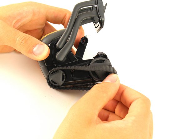

      • Remove the Anki Vector's belts on both sides of its body by gently sliding them off.
      • You should be able to pull them off without much effort.

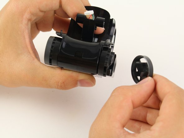

      • Pull off the covers attached to Vector's rear wheels.

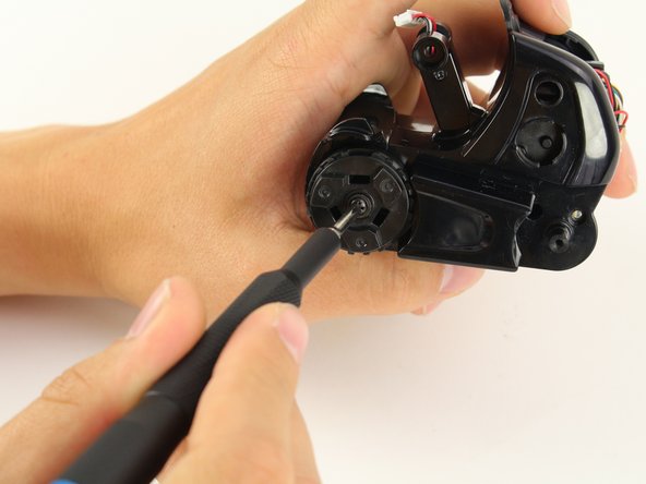

    4. Anki Vector  Battery Replacement: crwdns2935265:09crwdnd2935265:01crwdnd2935265:03crwdne2935265:0 Anki Vector  Battery Replacement: crwdns2935265:09crwdnd2935265:02crwdnd2935265:03crwdne2935265:0 Anki Vector  Battery Replacement: crwdns2935265:09crwdnd2935265:03crwdnd2935265:03crwdne2935265:0
      • Unscrew the 2 mm screws located under the wheel covers using a Phillips #0 screwdriver.
      • Remove the rear wheel.

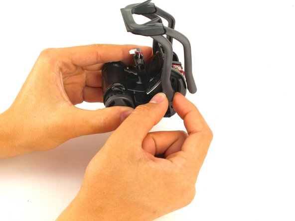

      • Raise vectors arms all the way up and gently pull each arm out of its socket.
    12. Anki Vector  Battery Replacement: crwdns2935265:017crwdnd2935265:01crwdnd2935265:02crwdne2935265:0 Anki Vector  Battery Replacement: crwdns2935265:017crwdnd2935265:02crwdnd2935265:02crwdne2935265:0

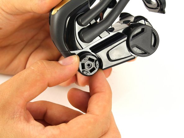

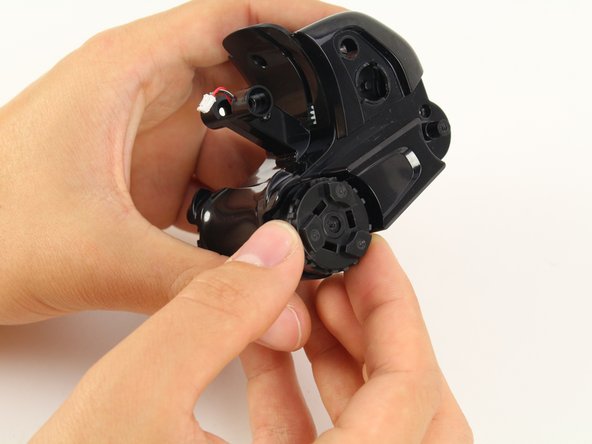

      • Pull the wheel covers off of Vectors forward wheels.

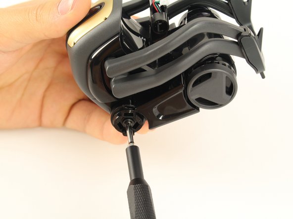

    13. Anki Vector  Battery Replacement: crwdns2935265:018crwdnd2935265:01crwdnd2935265:03crwdne2935265:0 Anki Vector  Battery Replacement: crwdns2935265:018crwdnd2935265:02crwdnd2935265:03crwdne2935265:0 Anki Vector  Battery Replacement: crwdns2935265:018crwdnd2935265:03crwdnd2935265:03crwdne2935265:0
      • Using the same Phillips #0 screwdriver, unscrew the 2 mm screw under the wheel cover.
      • Gently pull the wheel off.

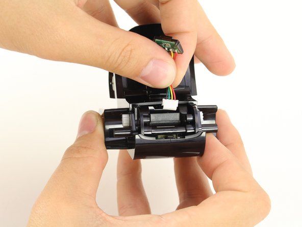

    15. Anki Vector  Battery Replacement: crwdns2935265:020crwdnd2935265:01crwdnd2935265:03crwdne2935265:0 Anki Vector  Battery Replacement: crwdns2935265:020crwdnd2935265:02crwdnd2935265:03crwdne2935265:0 Anki Vector  Battery Replacement: crwdns2935265:020crwdnd2935265:03crwdnd2935265:03crwdne2935265:0
      • Gently unplug and remove the infrared sensor.

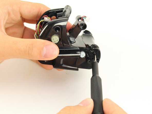

    16. Anki Vector  Battery Replacement: crwdns2935265:021crwdnd2935265:01crwdnd2935265:03crwdne2935265:0 Anki Vector  Battery Replacement: crwdns2935265:021crwdnd2935265:02crwdnd2935265:03crwdne2935265:0 Anki Vector  Battery Replacement: crwdns2935265:021crwdnd2935265:03crwdnd2935265:03crwdne2935265:0
      • Insert your Phillips #0 bit into a 4 mm nut driver and insert both into your bit driver.
      • Unscrew the three body screws.

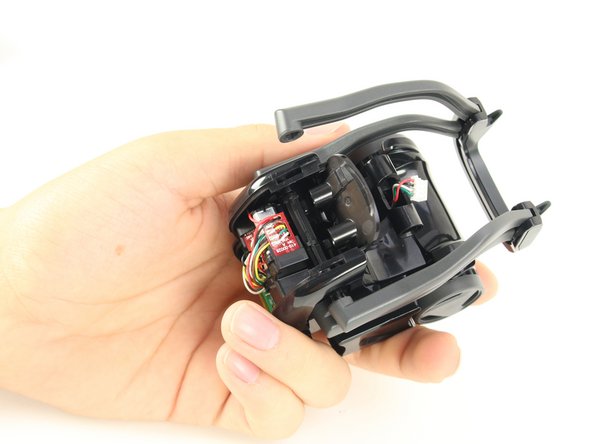

    17. Anki Vector  Battery Replacement: crwdns2935265:022crwdnd2935265:01crwdnd2935265:02crwdne2935265:0 Anki Vector  Battery Replacement: crwdns2935265:022crwdnd2935265:02crwdnd2935265:02crwdne2935265:0
      • Gradually increasing applied force, pull the body apart.

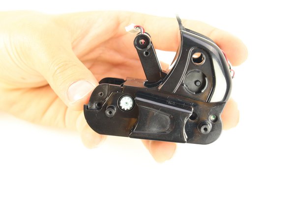

    18. Anki Vector  Battery Replacement: crwdns2935265:023crwdnd2935265:01crwdnd2935265:03crwdne2935265:0 Anki Vector  Battery Replacement: crwdns2935265:023crwdnd2935265:02crwdnd2935265:03crwdne2935265:0 Anki Vector  Battery Replacement: crwdns2935265:023crwdnd2935265:03crwdnd2935265:03crwdne2935265:0
      • Remove the shoulder panel.
      • Remove the weight.

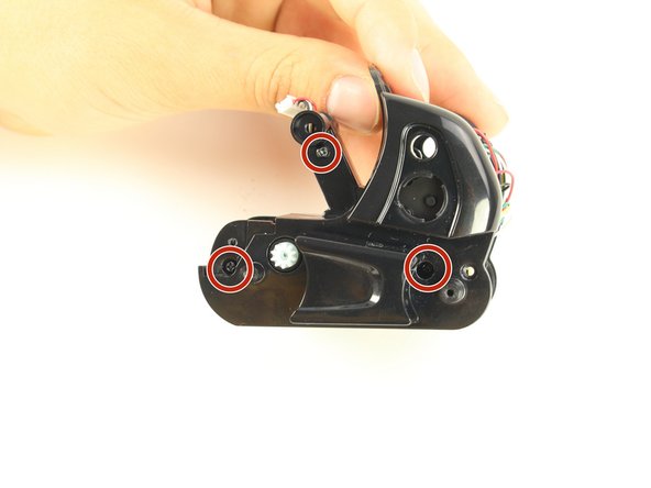

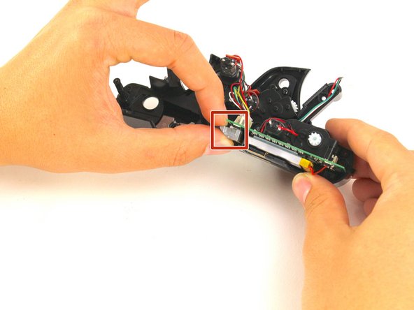

    19. Anki Vector  Battery Replacement: crwdns2935265:024crwdnd2935265:01crwdnd2935265:03crwdne2935265:0 Anki Vector  Battery Replacement: crwdns2935265:024crwdnd2935265:02crwdnd2935265:03crwdne2935265:0 Anki Vector  Battery Replacement: crwdns2935265:024crwdnd2935265:03crwdnd2935265:03crwdne2935265:0

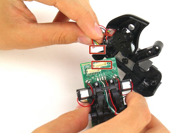

      • Unplug the two motor connectors from the motherboard.
    20. Anki Vector  Battery Replacement: crwdns2935265:025crwdnd2935265:01crwdnd2935265:03crwdne2935265:0 Anki Vector  Battery Replacement: crwdns2935265:025crwdnd2935265:02crwdnd2935265:03crwdne2935265:0 Anki Vector  Battery Replacement: crwdns2935265:025crwdnd2935265:03crwdnd2935265:03crwdne2935265:0
      • Wriggle the battery free from the motherboard.
      • Using a soldering iron, desolder the connections from the battery to the motherboard.
