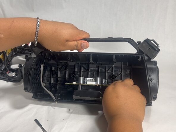

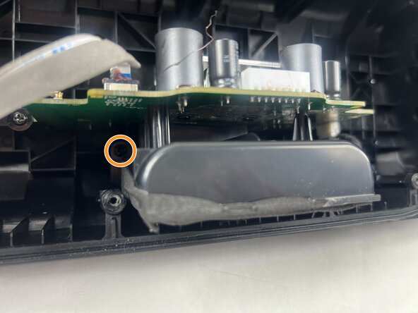

  11. Anker Soundcore Motion Boom Plus Charging Port Replacement, Charging Port: crwdns2935265:011crwdnd2935265:01crwdnd2935265:03crwdne2935265:0 Anker Soundcore Motion Boom Plus Charging Port Replacement, Charging Port: crwdns2935265:011crwdnd2935265:02crwdnd2935265:03crwdne2935265:0 Anker Soundcore Motion Boom Plus Charging Port Replacement, Charging Port: crwdns2935265:011crwdnd2935265:03crwdnd2935265:03crwdne2935265:0
    • Remove the three 12 mm Phillips screws securing the motherboard to the case.
    • Remove the two 10 mm Phillips screws surrounding the battery.

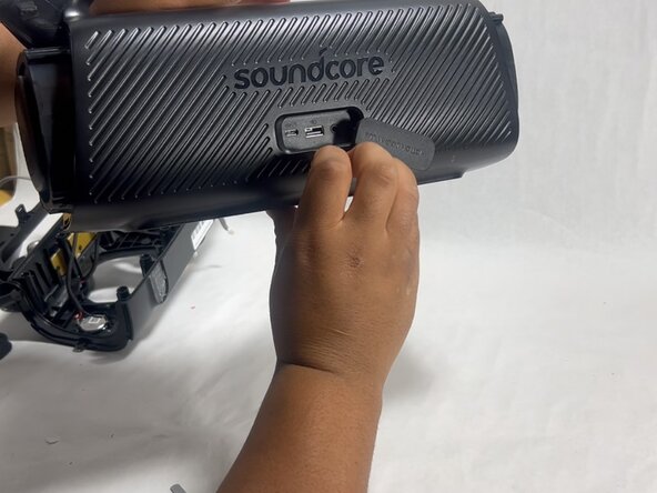

  12. Anker Soundcore Motion Boom Plus Charging Port Replacement: crwdns2935265:012crwdnd2935265:01crwdnd2935265:02crwdne2935265:0 Anker Soundcore Motion Boom Plus Charging Port Replacement: crwdns2935265:012crwdnd2935265:02crwdnd2935265:02crwdne2935265:0
    • Flip the speaker over and push the charging port inward.

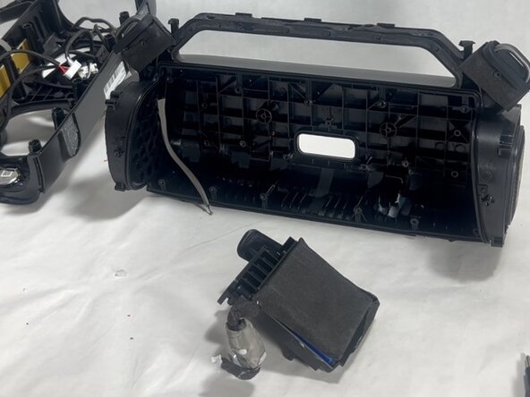

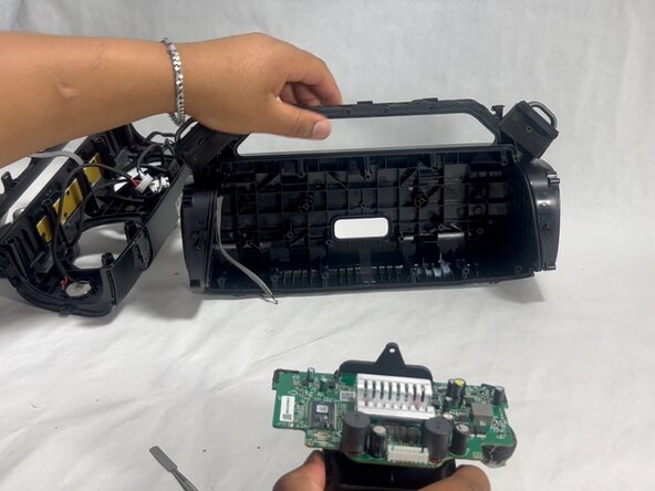

  13. Anker Soundcore Motion Boom Plus Charging Port Replacement: crwdns2935265:013crwdnd2935265:01crwdnd2935265:02crwdne2935265:0 Anker Soundcore Motion Boom Plus Charging Port Replacement: crwdns2935265:013crwdnd2935265:02crwdnd2935265:02crwdne2935265:0
    • Slide the motherboard and battery out by pushing through the charging port.
    • The motherboard and battery assembly should detach easily.

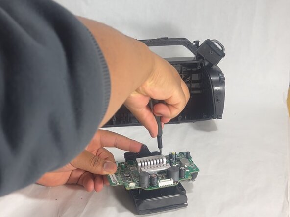

  14. Anker Soundcore Motion Boom Plus Charging Port Replacement: crwdns2935265:014crwdnd2935265:01crwdnd2935265:02crwdne2935265:0 Anker Soundcore Motion Boom Plus Charging Port Replacement: crwdns2935265:014crwdnd2935265:02crwdnd2935265:02crwdne2935265:0
    • Remove the five 10 mm Phillips screws securing the motherboard and battery together.
    • Gently lift the motherboard from the battery once all screws are removed.
    • Handle with care to avoid damaging any of the components.
  15. Anker Soundcore Motion Boom Plus Charging Port Replacement: crwdns2935265:015crwdnd2935265:01crwdnd2935265:01crwdne2935265:0
    • Gently pull the motherboard and battery apart.
  16. Anker Soundcore Motion Boom Plus Charging Port Replacement: crwdns2935265:016crwdnd2935265:01crwdnd2935265:02crwdne2935265:0 Anker Soundcore Motion Boom Plus Charging Port Replacement: crwdns2935265:016crwdnd2935265:02crwdnd2935265:02crwdne2935265:0
    • Remove the battery from the silicone/plastic holder and replace it.
    • The replacement should have a new charging port attached to it.
