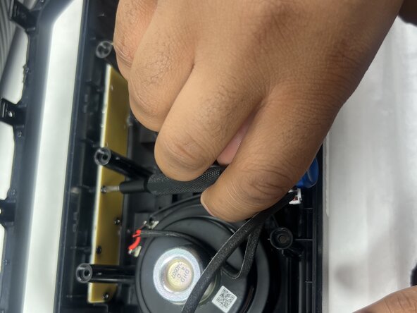

    1. Anker Soundcore Motion Boom Plus Button Panel Replacement, Button Panel: crwdns2935265:011crwdnd2935265:01crwdnd2935265:02crwdne2935265:0 Anker Soundcore Motion Boom Plus Button Panel Replacement, Button Panel: crwdns2935265:011crwdnd2935265:02crwdnd2935265:02crwdne2935265:0
      • Remove all eight 7 mm Phillips screws securing the button panel to the top of the case.
    2. Anker Soundcore Motion Boom Plus Button Panel Replacement: crwdns2935265:012crwdnd2935265:01crwdnd2935265:01crwdne2935265:0
      • Remove the button panel.
