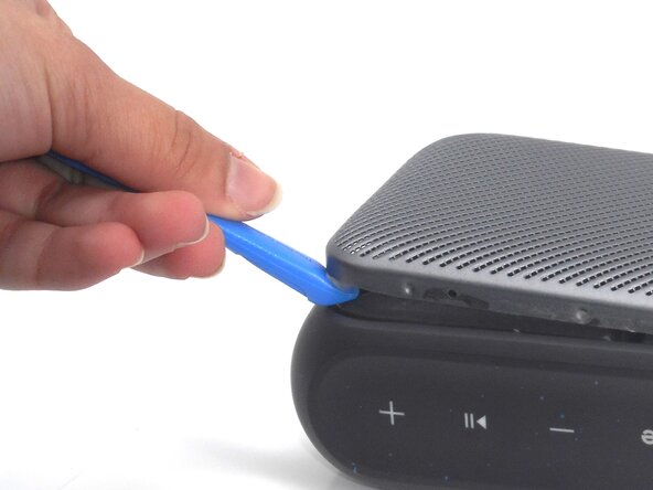

    • Insert an opening tool into a seam between the grille and chassis.
    • Gently pry the grille up to begin disengaging the retaining clip.
    • Once a corner starts to lift, slowly slide the tool along the edge to loosen more of the grille.

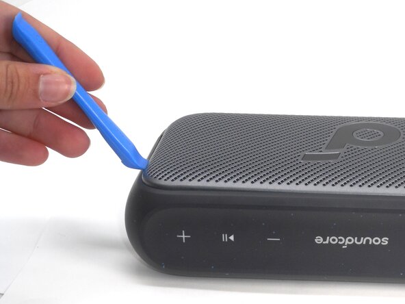

    • Keep working around the edges until all the clips are loose.
    • You may hear soft clicking sounds as the clips come undone.

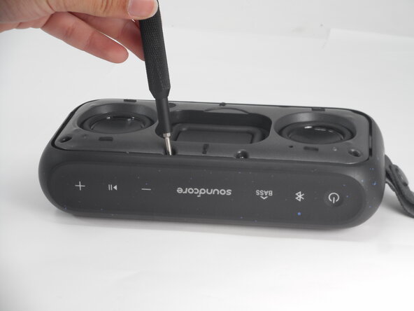

  4. Anker Soundcore Motion 300 Charging Port Replacement, Charging Port: crwdns2935265:04crwdnd2935265:01crwdnd2935265:03crwdne2935265:0 Anker Soundcore Motion 300 Charging Port Replacement, Charging Port: crwdns2935265:04crwdnd2935265:02crwdnd2935265:03crwdne2935265:0 Anker Soundcore Motion 300 Charging Port Replacement, Charging Port: crwdns2935265:04crwdnd2935265:03crwdnd2935265:03crwdne2935265:0

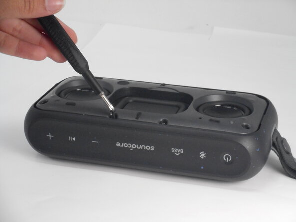

    • Use a Phillips #0 screwdriver to remove all eight 11.5 mm screws that secure the speaker housing.

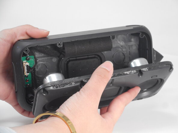

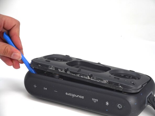

    • Use an opening tool to pry up the speaker housing.
    • Set the speaker housing beside the speaker, with care not to strain the cables connected to the drivers.
    • The speaker housing may be very difficult to remove due to adhesive. If necessary, use a hairdryer to lightly heat the perimeter of the housing to loosen the adhesive.

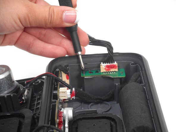

  6. Anker Soundcore Motion 300 Charging Port Replacement: crwdns2935265:06crwdnd2935265:01crwdnd2935265:03crwdne2935265:0 Anker Soundcore Motion 300 Charging Port Replacement: crwdns2935265:06crwdnd2935265:02crwdnd2935265:03crwdne2935265:0 Anker Soundcore Motion 300 Charging Port Replacement: crwdns2935265:06crwdnd2935265:03crwdnd2935265:03crwdne2935265:0

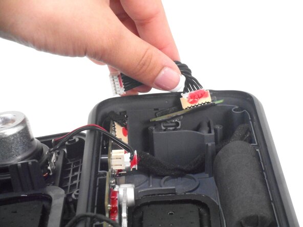

    • Use tweezers to scrape off the sealant that secures the charging port connector.
    • Pull the charging port connector directly out of its socket.
    • Use a Phillips #0 screwdriver to remove the two 7.5 mm screws securing the charging port PCB to the housing.
