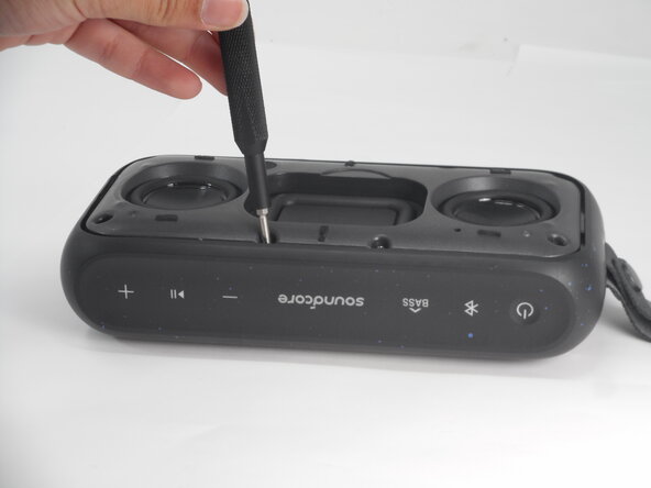

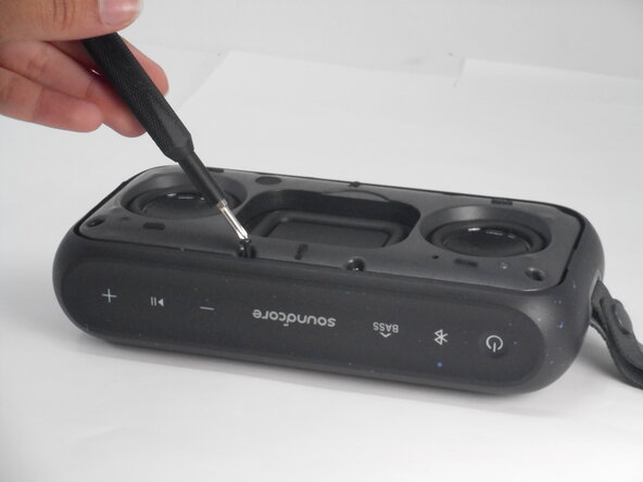

  4. Anker Soundcore Motion 300 Battery Replacement, Battery: crwdns2935265:04crwdnd2935265:01crwdnd2935265:03crwdne2935265:0 Anker Soundcore Motion 300 Battery Replacement, Battery: crwdns2935265:04crwdnd2935265:02crwdnd2935265:03crwdne2935265:0 Anker Soundcore Motion 300 Battery Replacement, Battery: crwdns2935265:04crwdnd2935265:03crwdnd2935265:03crwdne2935265:0
    • Use a Phillips #0 screwdriver to remove all eight 11.5 mm screws that secure the driver housing.

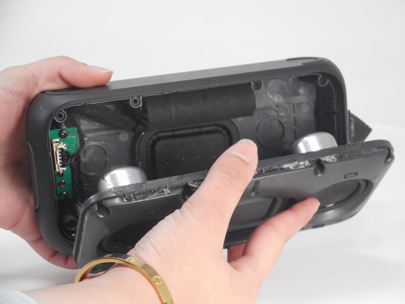

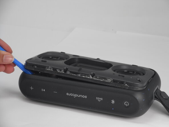

  5. Anker Soundcore Motion 300 Battery Replacement: crwdns2935265:05crwdnd2935265:01crwdnd2935265:03crwdne2935265:0 Anker Soundcore Motion 300 Battery Replacement: crwdns2935265:05crwdnd2935265:02crwdnd2935265:03crwdne2935265:0 Anker Soundcore Motion 300 Battery Replacement: crwdns2935265:05crwdnd2935265:03crwdnd2935265:03crwdne2935265:0
    • Use an opening tool to pry up the speaker housing.
    • Set the speaker housing beside the speaker, with care not to strain the cables connected to the drivers.
    • The speaker housing may be very difficult to remove due to adhesive. If necessary, use a hairdryer to lightly heat the perimeter of the housing to loosen the adhesive.

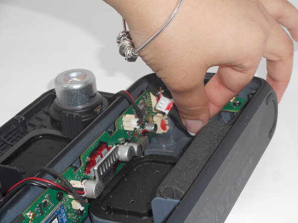

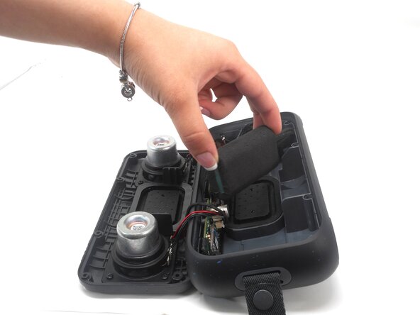

  6. Anker Soundcore Motion 300 Battery Replacement: crwdns2935265:06crwdnd2935265:01crwdnd2935265:03crwdne2935265:0 Anker Soundcore Motion 300 Battery Replacement: crwdns2935265:06crwdnd2935265:02crwdnd2935265:03crwdne2935265:0 Anker Soundcore Motion 300 Battery Replacement: crwdns2935265:06crwdnd2935265:03crwdnd2935265:03crwdne2935265:0
    • Use tweezers to remove the sealant that secures the battery connector.
    • Pull the battery connector directly out of its port.
    • Lift the battery up and out of the chassis.
