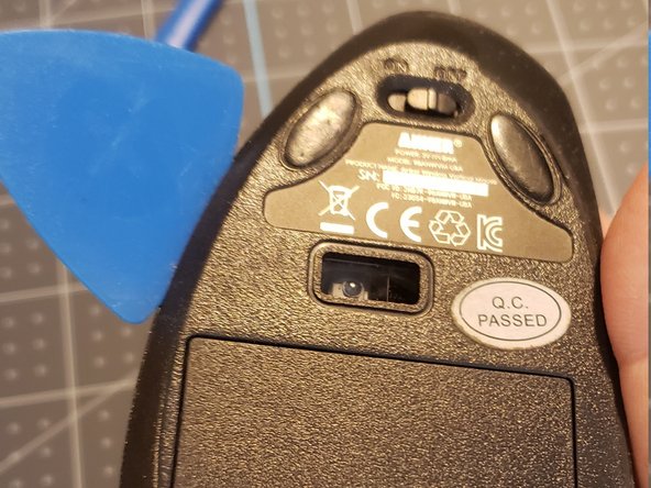

    • Flip the mouse over so that the bottom is facing up.
    • Using a prying tool to peel off the black stickers from the bottom of the mouse.

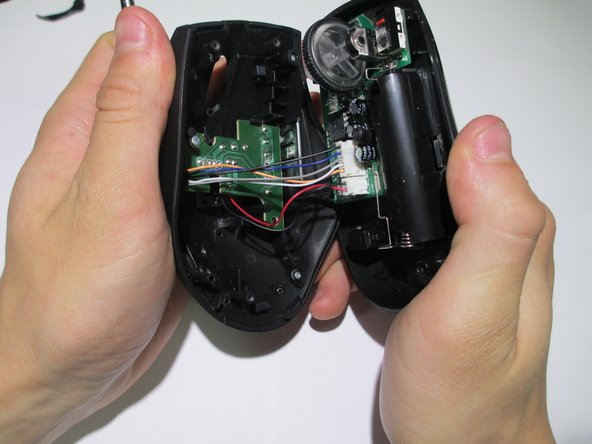

  4. Anker 2.4G Wireless Mouse Side Button Replacement: crwdns2935265:04crwdnd2935265:01crwdnd2935265:01crwdne2935265:0
    • After separating the halves, remove the housing wires from the white crimp headers to separate the upper and lower housing units of the mouse.
    • Potential for device damage: Pull as far up on the wire as possible to avoid ripping the wires.

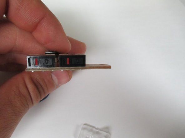

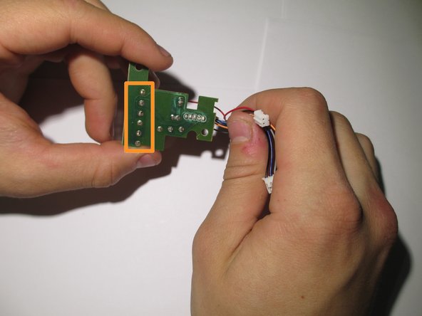

  7. Anker 2.4G Wireless Mouse Side Button Replacement: crwdns2935265:07crwdnd2935265:01crwdnd2935265:03crwdne2935265:0 Anker 2.4G Wireless Mouse Side Button Replacement: crwdns2935265:07crwdnd2935265:02crwdnd2935265:03crwdne2935265:0 Anker 2.4G Wireless Mouse Side Button Replacement: crwdns2935265:07crwdnd2935265:03crwdnd2935265:03crwdne2935265:0
    • Left on the brown-colored bottom of the board, there are two black-and-white boxes. These are the side buttons.
    • Flip the board over to reveal the green-colored side.
    • Desolder the six silver pins to disconnect the side buttons.
    • Once desoldered, remove the old side buttons.
    • Resolder the pins of the new buttons onto the board.
