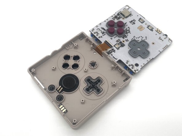

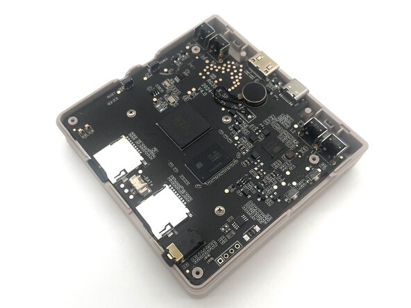

    • Lift up the green sheet of paper from the motherboard.
  7. Anbernic RG35XXSP Speaker Replacement: crwdns2935265:07crwdnd2935265:01crwdnd2935265:03crwdne2935265:0 Anbernic RG35XXSP Speaker Replacement: crwdns2935265:07crwdnd2935265:02crwdnd2935265:03crwdne2935265:0 Anbernic RG35XXSP Speaker Replacement: crwdns2935265:07crwdnd2935265:03crwdnd2935265:03crwdne2935265:0

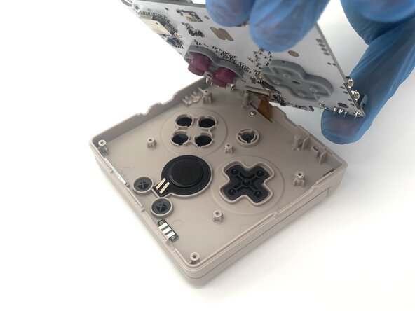

    • Use a Phillips #00 screwdriver to remove the three 5 mm screws that secure the motherboard.
    • Lift up the motherboard from the main body and flip it to the other side to reveal the speaker.
  8. Anbernic RG35XXSP Speaker Replacement: crwdns2935265:08crwdnd2935265:01crwdnd2935265:01crwdne2935265:0
    • Remove the speaker from the device.
