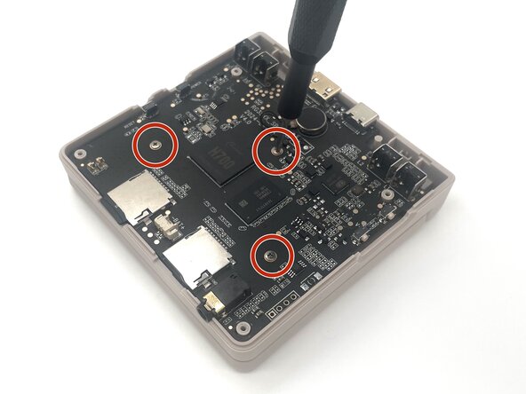

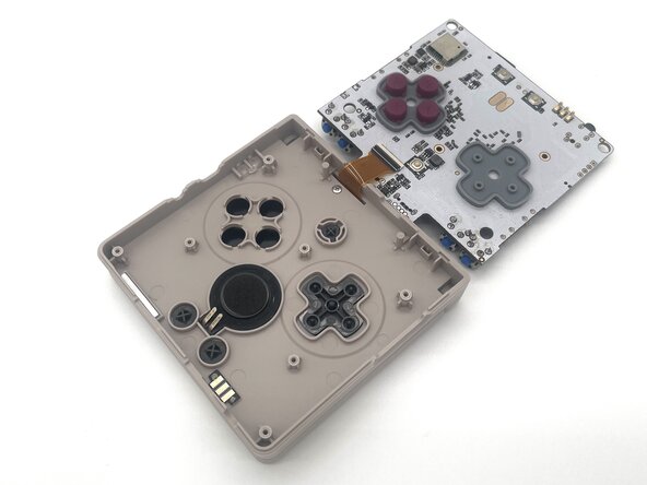

  6. Anbernic RG35XXSP Case Replacement, Motherboard: crwdns2935265:06crwdnd2935265:01crwdnd2935265:02crwdne2935265:0 Anbernic RG35XXSP Case Replacement, Motherboard: crwdns2935265:06crwdnd2935265:02crwdnd2935265:02crwdne2935265:0
    • Lift up the green sheet of paper from the motherboard.
    • Use a Phillips #00 screwdriver to remove the three 5 mm screws from the motherboard.

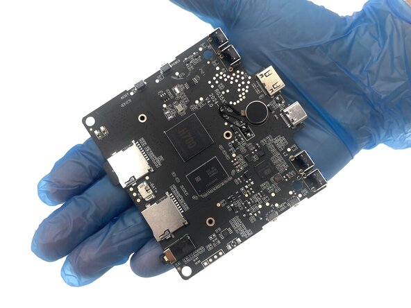

  7. Anbernic RG35XXSP Case Replacement: crwdns2935265:07crwdnd2935265:01crwdnd2935265:02crwdne2935265:0 Anbernic RG35XXSP Case Replacement: crwdns2935265:07crwdnd2935265:02crwdnd2935265:02crwdne2935265:0
    • Be careful when moving the motherboard as it is connected to the display ribbon cable, and can be damaged if pulled on.
    • Pick up the motherboard and flip it over.

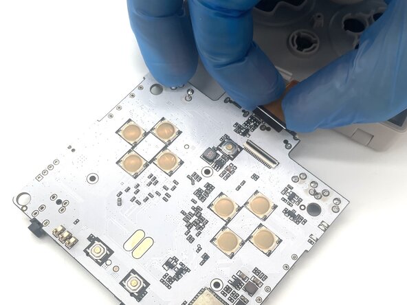

  8. Anbernic RG35XXSP Case Replacement: crwdns2935265:08crwdnd2935265:01crwdnd2935265:03crwdne2935265:0 Anbernic RG35XXSP Case Replacement: crwdns2935265:08crwdnd2935265:02crwdnd2935265:03crwdne2935265:0 Anbernic RG35XXSP Case Replacement: crwdns2935265:08crwdnd2935265:03crwdnd2935265:03crwdne2935265:0
    • Use a spudger or a clean fingernail to flip up the black locking flap—this is the unlocked position.
    • Use the widest tool possible to avoid damaging the delicate hinge pins.
    • Use tweezers or your fingers to gently pull the display cable out of its socket.
    • Remove the motherboard.

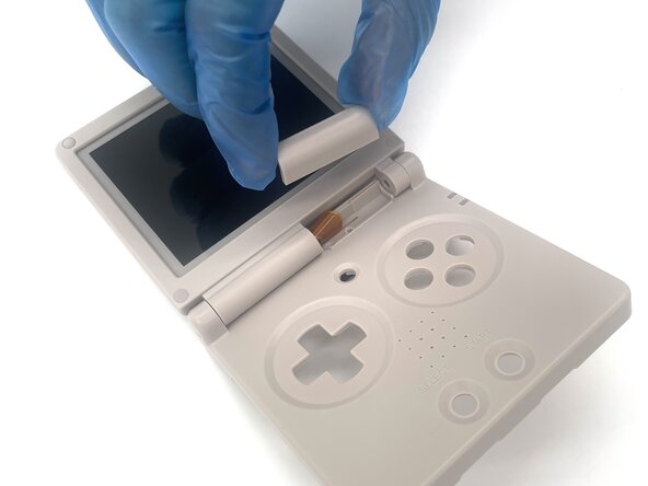

  9. Anbernic RG35XXSP Case Replacement, Case: crwdns2935265:09crwdnd2935265:01crwdnd2935265:03crwdne2935265:0 Anbernic RG35XXSP Case Replacement, Case: crwdns2935265:09crwdnd2935265:02crwdnd2935265:03crwdne2935265:0 Anbernic RG35XXSP Case Replacement, Case: crwdns2935265:09crwdnd2935265:03crwdnd2935265:03crwdne2935265:0
    • Use a Phillips #00 to remove the single 5 mm screw located next to the display ribbon cable.
    • Flip the device over so it's facing up and remove the loose plastic hinge cover.

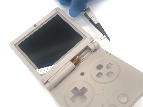

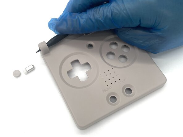

  10. Anbernic RG35XXSP Case Replacement: crwdns2935265:010crwdnd2935265:01crwdnd2935265:03crwdne2935265:0 Anbernic RG35XXSP Case Replacement: crwdns2935265:010crwdnd2935265:02crwdnd2935265:03crwdne2935265:0 Anbernic RG35XXSP Case Replacement: crwdns2935265:010crwdnd2935265:03crwdnd2935265:03crwdne2935265:0
    • Use the pointed end of a spudger to push out the pin from the edge of the hinges.
    • Use tweezers to pull both the plastic covering the pin and the pin itself.

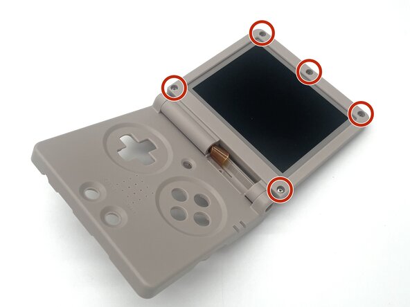

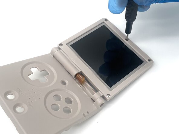

  11. Anbernic RG35XXSP Case Replacement: crwdns2935265:011crwdnd2935265:01crwdnd2935265:03crwdne2935265:0 Anbernic RG35XXSP Case Replacement: crwdns2935265:011crwdnd2935265:02crwdnd2935265:03crwdne2935265:0 Anbernic RG35XXSP Case Replacement: crwdns2935265:011crwdnd2935265:03crwdnd2935265:03crwdne2935265:0
    • Use a spudger to pry off plastic screw covers from the screws around the edge of the screen.
    • Use a Phillips #00 screwdriver to remove the five 5 mm screws around the bezel of the screen.

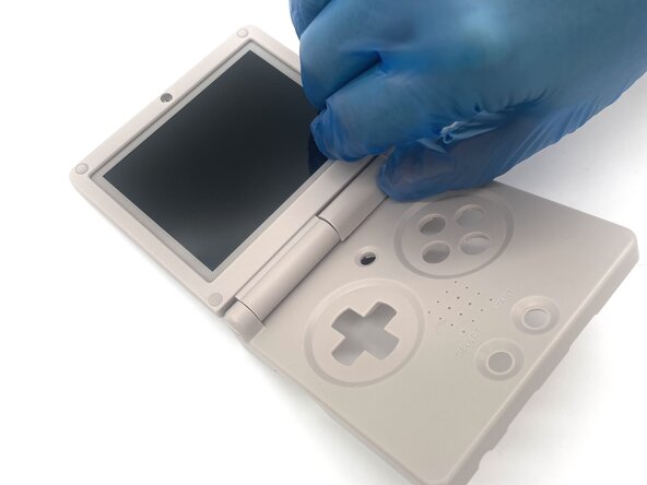

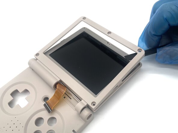

  12. Anbernic RG35XXSP Case Replacement: crwdns2935265:012crwdnd2935265:01crwdnd2935265:03crwdne2935265:0 Anbernic RG35XXSP Case Replacement: crwdns2935265:012crwdnd2935265:02crwdnd2935265:03crwdne2935265:0 Anbernic RG35XXSP Case Replacement: crwdns2935265:012crwdnd2935265:03crwdnd2935265:03crwdne2935265:0
    • Place the end of a spudger in between the two layers of the screen cover and pry it open.
    • Remove the screen from the plastic casing.
    • Be sure not to apply too much pressure on the screen as it is very thin and prone to cracking.

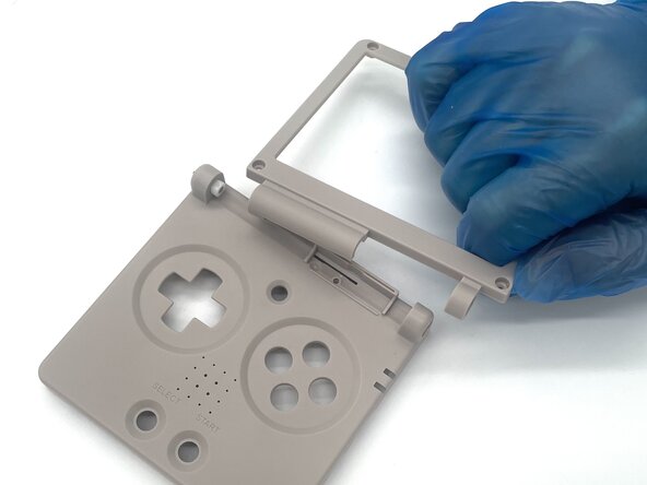

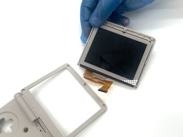

  13. Anbernic RG35XXSP Case Replacement: crwdns2935265:013crwdnd2935265:01crwdnd2935265:02crwdne2935265:0 Anbernic RG35XXSP Case Replacement: crwdns2935265:013crwdnd2935265:02crwdnd2935265:02crwdne2935265:0
    • Detach the plastic screen cover from the device.

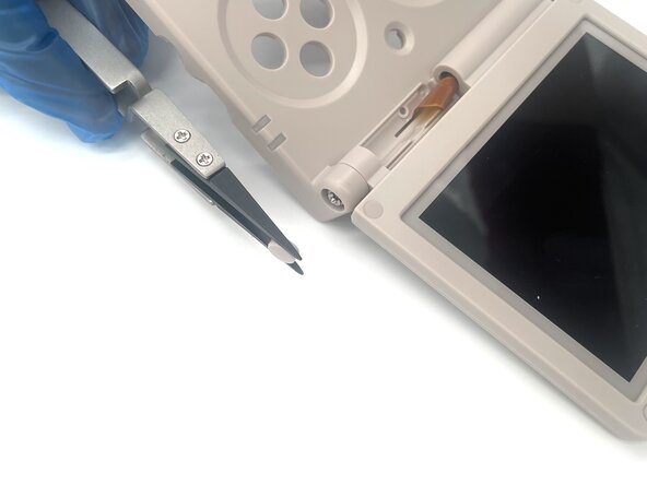

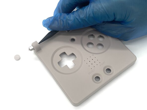

  14. Anbernic RG35XXSP Case Replacement: crwdns2935265:014crwdnd2935265:01crwdnd2935265:03crwdne2935265:0 Anbernic RG35XXSP Case Replacement: crwdns2935265:014crwdnd2935265:02crwdnd2935265:03crwdne2935265:0 Anbernic RG35XXSP Case Replacement: crwdns2935265:014crwdnd2935265:03crwdnd2935265:03crwdne2935265:0
    • Use the pointed end of a spudger to push the last pin out of the hinge.
