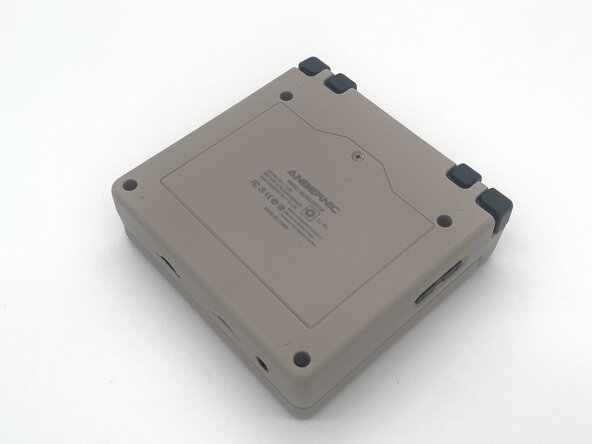

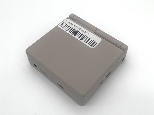

    • Power the device off before starting the disassembly process.
    • Close the device and turn it over so the bottom faces upward.
  2. Anbernic RG35XXSP Battery Replacement: crwdns2935265:02crwdnd2935265:01crwdnd2935265:02crwdne2935265:0 Anbernic RG35XXSP Battery Replacement: crwdns2935265:02crwdnd2935265:02crwdnd2935265:02crwdne2935265:0

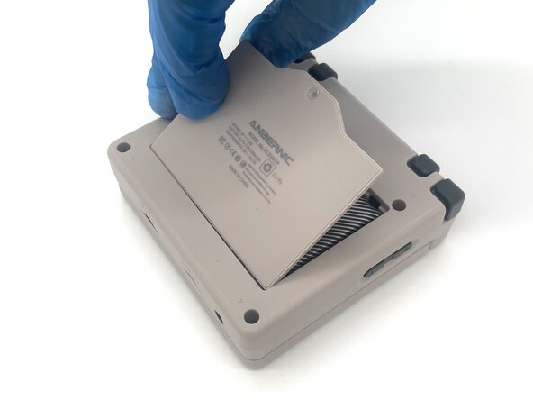

    • Use a Phillips #00 screwdriver to remove the single 5 mm screw securing the battery cover.
    • Lift the battery door and remove it.

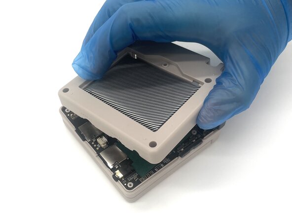

  3. Anbernic RG35XXSP Battery Replacement: crwdns2935265:03crwdnd2935265:01crwdnd2935265:02crwdne2935265:0 Anbernic RG35XXSP Battery Replacement: crwdns2935265:03crwdnd2935265:02crwdnd2935265:02crwdne2935265:0

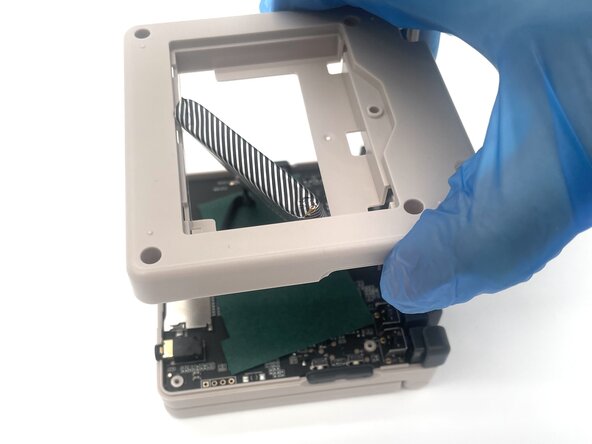

    • Use a T6 Torx screwdriver to remove the four 5 mm screws.
    • Lift the whole back case with the battery from the device.
    • Don't pull it away because the battery is connected to the board.

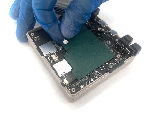

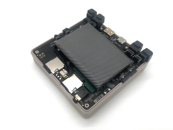

  4. Anbernic RG35XXSP Battery Replacement: crwdns2935265:04crwdnd2935265:01crwdnd2935265:03crwdne2935265:0 Anbernic RG35XXSP Battery Replacement: crwdns2935265:04crwdnd2935265:02crwdnd2935265:03crwdne2935265:0 Anbernic RG35XXSP Battery Replacement: crwdns2935265:04crwdnd2935265:03crwdnd2935265:03crwdne2935265:0
    • Remove the battery from the back compartment and fit it through the gap in the back case.
    • Put the plastic case aside for reassembly.

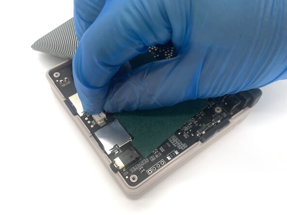

  5. Anbernic RG35XXSP Battery Replacement: crwdns2935265:05crwdnd2935265:01crwdnd2935265:03crwdne2935265:0 Anbernic RG35XXSP Battery Replacement: crwdns2935265:05crwdnd2935265:02crwdnd2935265:03crwdne2935265:0 Anbernic RG35XXSP Battery Replacement: crwdns2935265:05crwdnd2935265:03crwdnd2935265:03crwdne2935265:0
    • Pinch the sides of the battery connector and slide it from the socket to disconnect the battery cable.
    • Remove the battery.
