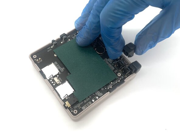

    • Pinch the R2 button and gently lift it to remove it.
    • Pinch the R1 button and gently lift it to remove it.
    • You will have to pull a little harder as it has a plastic pin that is connected to the body.

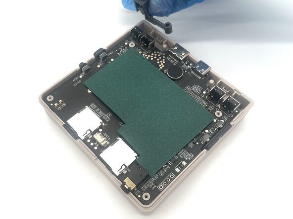

  7. Anbernic RG35XXSP Action Buttons Replacement: crwdns2935265:07crwdnd2935265:01crwdnd2935265:02crwdne2935265:0 Anbernic RG35XXSP Action Buttons Replacement: crwdns2935265:07crwdnd2935265:02crwdnd2935265:02crwdne2935265:0
    • Pinch the L2 button and gently lift it to remove it.
    • Pinch the L1 button and gently lift it to remove it.

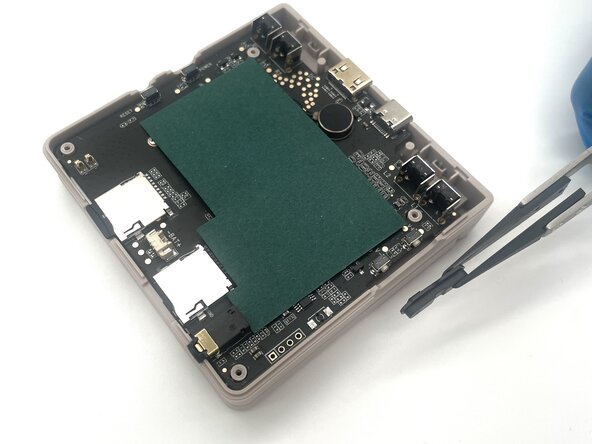

    • Use tweezers to pull the power & reset buttons up from the side of the device
  9. Anbernic RG35XXSP Action Buttons Replacement: crwdns2935265:09crwdnd2935265:01crwdnd2935265:02crwdne2935265:0 Anbernic RG35XXSP Action Buttons Replacement: crwdns2935265:09crwdnd2935265:02crwdnd2935265:02crwdne2935265:0
    • Use tweezers to remove the volume buttons from the side of the case.
    • The plus side of the buttons should be closer to the back of the device.

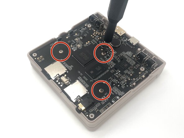

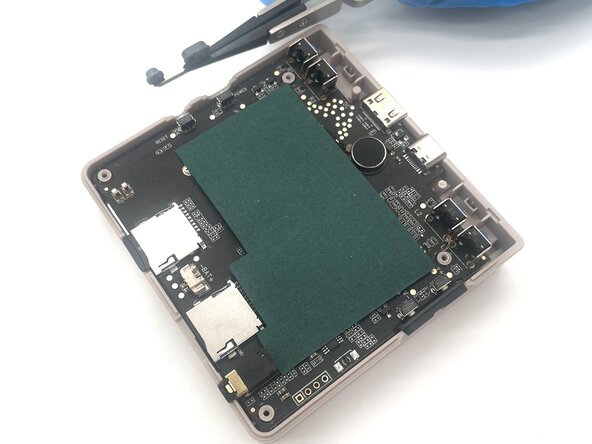

  10. Anbernic RG35XXSP Action Buttons Replacement: crwdns2935265:010crwdnd2935265:01crwdnd2935265:03crwdne2935265:0 Anbernic RG35XXSP Action Buttons Replacement: crwdns2935265:010crwdnd2935265:02crwdnd2935265:03crwdne2935265:0 Anbernic RG35XXSP Action Buttons Replacement: crwdns2935265:010crwdnd2935265:03crwdnd2935265:03crwdne2935265:0
    • Remove the green paper sheet from the motherboard.
    • Use a Phillips #00 screwdriver to remove the three 5 mm screws from the motherboard.

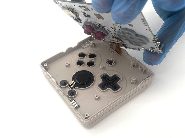

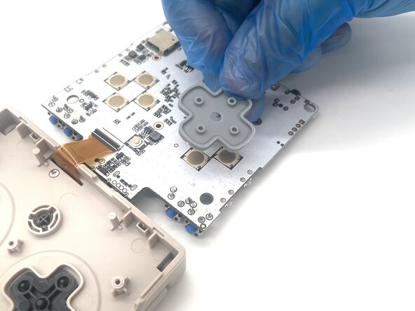

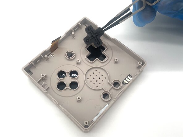

  11. Anbernic RG35XXSP Action Buttons Replacement: crwdns2935265:011crwdnd2935265:01crwdnd2935265:03crwdne2935265:0 Anbernic RG35XXSP Action Buttons Replacement: crwdns2935265:011crwdnd2935265:02crwdnd2935265:03crwdne2935265:0 Anbernic RG35XXSP Action Buttons Replacement: crwdns2935265:011crwdnd2935265:03crwdnd2935265:03crwdne2935265:0
    • Flip the motherboard over to reveal the action and directional buttons.
    • Remove the action and directional button gaskets from the motherboard.
    • In some cases, the gaskets may get stuck in the plastic case. If this happens, you can still take out the buttons like normal.

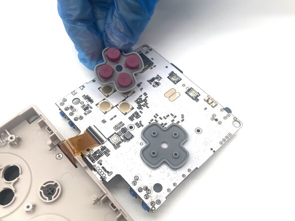

  12. Anbernic RG35XXSP Action Buttons Replacement: crwdns2935265:012crwdnd2935265:01crwdnd2935265:02crwdne2935265:0 Anbernic RG35XXSP Action Buttons Replacement: crwdns2935265:012crwdnd2935265:02crwdnd2935265:02crwdne2935265:0
    • Use tweezers to remove the directional buttons from the case.
To reassemble your device, follow these instructions in reverse order. Take your e-waste to an R2 or e-Stewards certified recycler.
