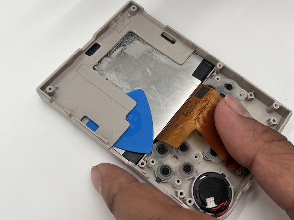

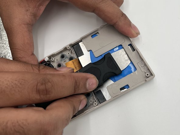

  7. Anbernic RG35XX Screen Replacement, Screen: crwdns2935265:07crwdnd2935265:01crwdnd2935265:01crwdne2935265:0
    • The wire is not part of the sticker.
    • Remove the black sticker on the back of the screen.
  8. Anbernic RG35XX Screen Replacement: crwdns2935265:08crwdnd2935265:01crwdnd2935265:03crwdne2935265:0 Anbernic RG35XX Screen Replacement: crwdns2935265:08crwdnd2935265:02crwdnd2935265:03crwdne2935265:0 Anbernic RG35XX Screen Replacement: crwdns2935265:08crwdnd2935265:03crwdnd2935265:03crwdne2935265:0
    • The screen is attached with adhesive.
    • Do not heat the device too much, stop at regular intervals and insure that no pieces are being affected badly.
    • Use a hair dryer to gently heat the rear of the screen until it's almost too hot to touch.
    • Insert a jimmy between the screen and plastic bracket. Once a slim gap is opened, insert an opening pick between the plastic bracket and rear screen.
    • Reheat the screen as needed.
    • Continue to insert opening picks around the entire perimeter of the screen as you pry to avoid the adhesive from reengaging.
    • Once the screen fully releases, remove it.
