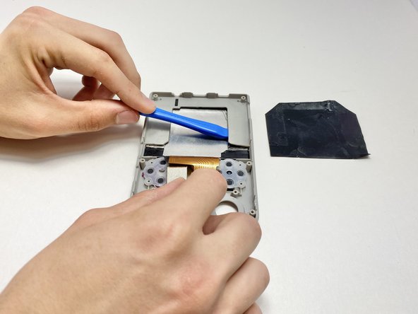

  8. Anbernic RG353V Screen Replacement, Screen: crwdns2935265:08crwdnd2935265:01crwdnd2935265:02crwdne2935265:0 Anbernic RG353V Screen Replacement, Screen: crwdns2935265:08crwdnd2935265:02crwdnd2935265:02crwdne2935265:0
    • Remove the black tape at the top of the device.
    • Make sure to keep this as you will need to put it back on later.
    • Insert the iFixit opening tool in between the case frame and the metal screen plate to separate the adhesive from each side.
    • Take your time with this step to avoid damaging the device, as the adhesive is very strong.

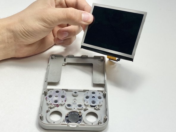

  9. Anbernic RG353V Screen Replacement: crwdns2935265:09crwdnd2935265:01crwdnd2935265:03crwdne2935265:0 Anbernic RG353V Screen Replacement: crwdns2935265:09crwdnd2935265:02crwdnd2935265:03crwdne2935265:0 Anbernic RG353V Screen Replacement: crwdns2935265:09crwdnd2935265:03crwdnd2935265:03crwdne2935265:0
    • Press the metal plate from behind with your thumb to gently push the screen out.
    • The ribbon cables will come out along with it.
    • If the adhesive was not released sufficiently in the previous step, you may need to go back with a spudger and pry along the area to loosen the connection.
