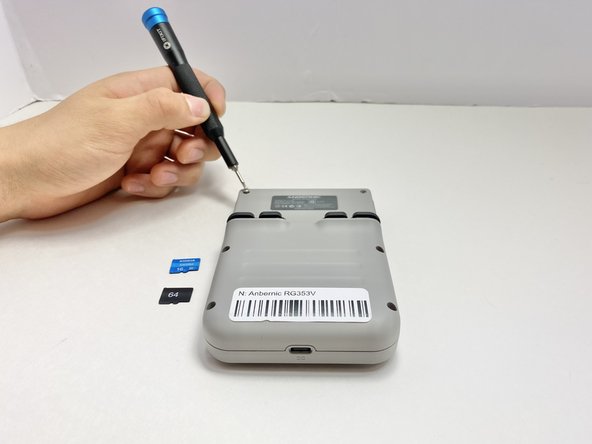

    • Make sure to remove the SD cards from the device before repair. Push them inwards so that they pop out of their respective slots.
    • Use a 2 mm Hex screwdriver to remove the six 7 mm screws from the back case of the handheld game.

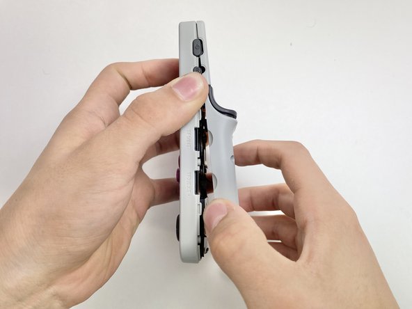

    • Use an opening tool to pry the top and bottom of the game apart. Work the tool around the perimeter of the device between the seam to release the snap tabs.
    • Separate the top and bottom cases gently.
    • Don't pull them apart as they are connected by cables and pulling them could rip the wires and damage the device.
