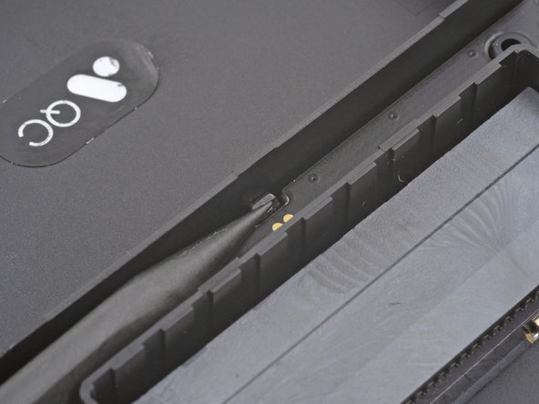

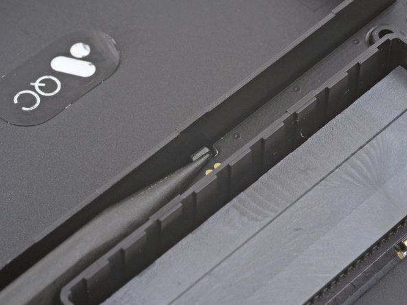

  6. Analogue Pocket Button Board Replacement, Unclip the button board: crwdns2935265:06crwdnd2935265:01crwdnd2935265:03crwdne2935265:0 Analogue Pocket Button Board Replacement, Unclip the button board: crwdns2935265:06crwdnd2935265:02crwdnd2935265:03crwdne2935265:0 Analogue Pocket Button Board Replacement, Unclip the button board: crwdns2935265:06crwdnd2935265:03crwdnd2935265:03crwdne2935265:0
    • A plastic clip secures the center of the button board.
    • Use the point of a spudger to push the clip out and release the board.
    • Don't try to remove the board—a delicate ribbon cable secures it to the device.

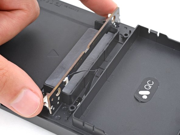

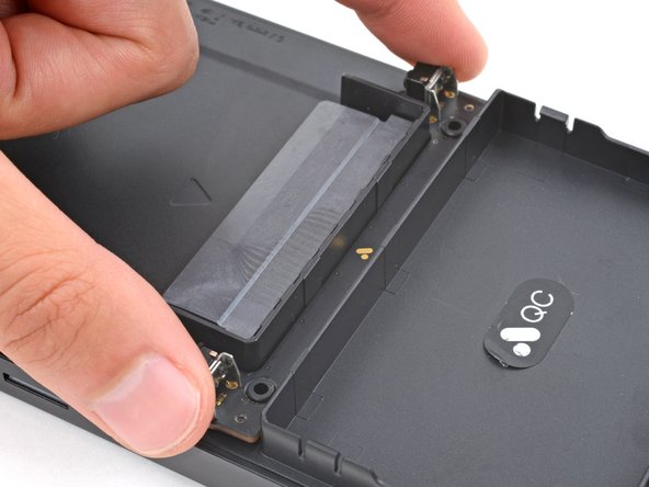

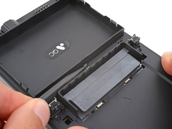

  7. Analogue Pocket Button Board Replacement, Reposition the button board: crwdns2935265:07crwdnd2935265:01crwdnd2935265:03crwdne2935265:0 Analogue Pocket Button Board Replacement, Reposition the button board: crwdns2935265:07crwdnd2935265:02crwdnd2935265:03crwdne2935265:0 Analogue Pocket Button Board Replacement, Reposition the button board: crwdns2935265:07crwdnd2935265:03crwdnd2935265:03crwdne2935265:0
    • Swing the bottom edge of the button board up and over the cartridge reader.
    • Set the board on top of the cartridge reader so the cable's connector is facing the bottom of the device.
    • During reassembly:
    • Put the top edges of the board under their tabs on the rear shell.
    • Lay the board onto the rear shell so the alignment posts go into their circular cutouts on the board.
    • Press the board down until the plastic clip engages.

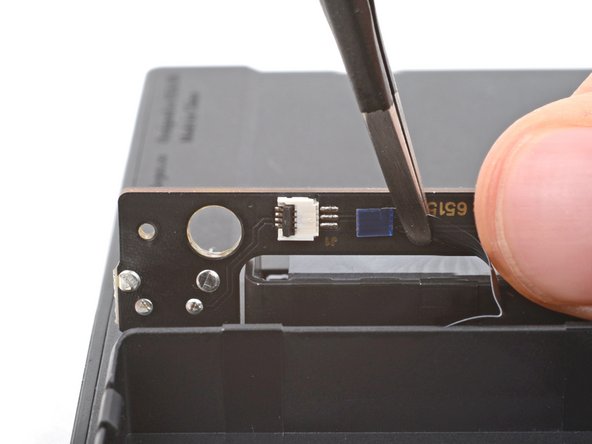

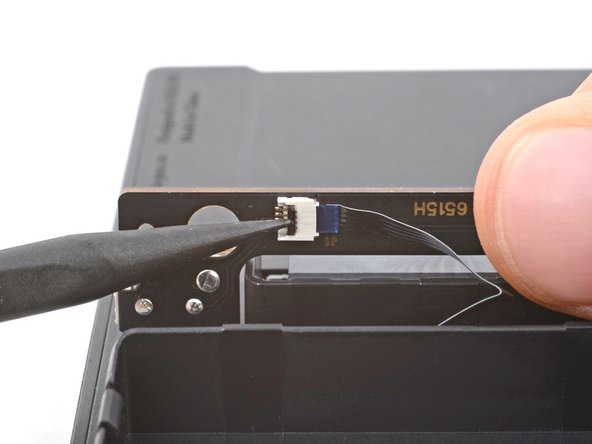

  8. Analogue Pocket Button Board Replacement, Disconnect the button board: crwdns2935265:08crwdnd2935265:01crwdnd2935265:03crwdne2935265:0 Analogue Pocket Button Board Replacement, Disconnect the button board: crwdns2935265:08crwdnd2935265:02crwdnd2935265:03crwdne2935265:0 Analogue Pocket Button Board Replacement, Disconnect the button board: crwdns2935265:08crwdnd2935265:03crwdnd2935265:03crwdne2935265:0
    • Use the tip of a spudger or a clean fingernail to flip up the hinged locking flap on the board cable ZIF connector located on the board itself.
    • Use blunt nose tweezers to pull the cable straight out of its socket.

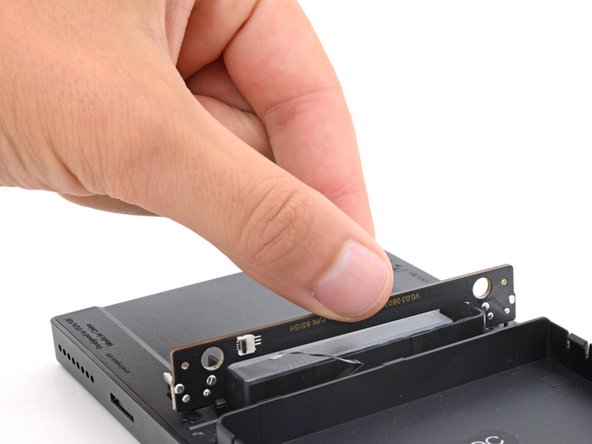

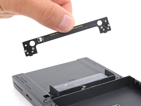

  9. Analogue Pocket Button Board Replacement, Remove the board: crwdns2935265:09crwdnd2935265:01crwdnd2935265:02crwdne2935265:0 Analogue Pocket Button Board Replacement, Remove the board: crwdns2935265:09crwdnd2935265:02crwdnd2935265:02crwdne2935265:0
    • Remove the board.

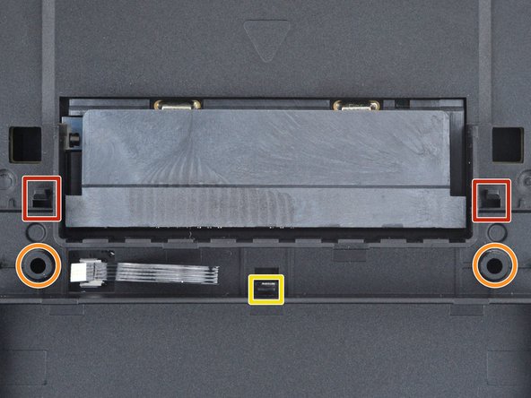

  10. Analogue Pocket Button Board Replacement, Remove the old cable: crwdns2935265:010crwdnd2935265:01crwdnd2935265:03crwdne2935265:0 Analogue Pocket Button Board Replacement, Remove the old cable: crwdns2935265:010crwdnd2935265:02crwdnd2935265:03crwdne2935265:0 Analogue Pocket Button Board Replacement, Remove the old cable: crwdns2935265:010crwdnd2935265:03crwdnd2935265:03crwdne2935265:0
    • If you suspect your board's cable is damaged, or your new board comes with a cable, follow the next three steps to remove the old one.

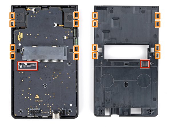

    • Sliding tabs secure the perimeter of the rear shell.
    • Firmly grip your device with one hand.
    • With your free hand, lift the bottom edge of the rear shell until it clears the front shell.
    • Pull the rear shell down until the sliding tabs disengage.

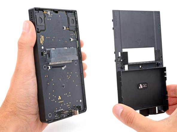

  11. Analogue Pocket Button Board Replacement: crwdns2935265:011crwdnd2935265:01crwdnd2935265:03crwdne2935265:0 Analogue Pocket Button Board Replacement: crwdns2935265:011crwdnd2935265:02crwdnd2935265:03crwdne2935265:0 Analogue Pocket Button Board Replacement: crwdns2935265:011crwdnd2935265:03crwdnd2935265:03crwdne2935265:0
    • Remove the rear shell.
    • Thread the button board cable through its slot in the rear shell.
    • Lay the rear shell on the front shell so its bottom edge overhangs slightly.
    • This allows the tabs to slide into place. If the rear shell is perfectly flush with the front shell, the tabs won't slide.
    • Push the rear shell in and slide it up to engage the sliding tabs.
  12. Analogue Pocket Button Board Replacement: crwdns2935265:012crwdnd2935265:01crwdnd2935265:03crwdne2935265:0 Analogue Pocket Button Board Replacement: crwdns2935265:012crwdnd2935265:02crwdnd2935265:03crwdne2935265:0 Analogue Pocket Button Board Replacement: crwdns2935265:012crwdnd2935265:03crwdnd2935265:03crwdne2935265:0
    • Use the tip of a spudger or a clean fingernail to flip up the hinged locking flap on the board cable ZIF connector to the bottom left of the cartridge reader.
