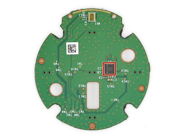

    • Undeterred, we turn our attention spudger to the rubberized control panel at the other end.
    • With some assertive prying, the plastic clips give way to reveal a control button breakout board featuring some buttons, a microphone, and a lone IC:
    • National Semiconductor LP55231 Programmable 9-Output LED Driver (as seen in the Echo and Echo Dot)
    • Unfortunately, there are no fasteners lurking at this end either. Time to get creative destructive!

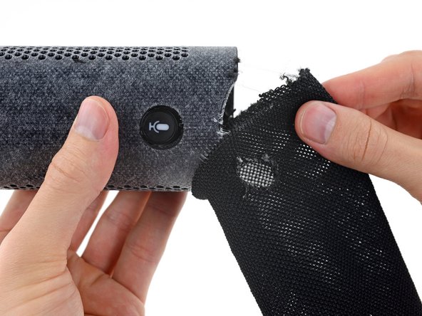

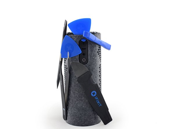

    • Thwarted by a lack of screws at either end, it seems that there's no easy way to Alexa's heart. So, let's do things the hard way.
    • First off of the Tap's cowling is the stretchy fabric wrap, which we unroll from the cowling's firmly adhered outer surface.
    • Aaaaand still no screws.
    • What we have here is a sticky situation. Many a brave pry tool met its doom attempting to bypass the Tap's flypaper exterior.
  6. Amazon Tap Teardown: crwdns2935265:06crwdnd2935265:01crwdnd2935265:03crwdne2935265:0 Amazon Tap Teardown: crwdns2935265:06crwdnd2935265:02crwdnd2935265:03crwdne2935265:0 Amazon Tap Teardown: crwdns2935265:06crwdnd2935265:03crwdnd2935265:03crwdne2935265:0
    • After a good amount of finagling, we finally manage to wriggle the cowling free by sliding it over the power, Bluetooth, and microphone buttons.
    • It may not look like progress, but it is. Just a few screws stand between us and those Taptastic interior goodies.
    • Suddenly the microphone button comes out all willing-like. That would have been helpful in the prior step, but we'll take it!

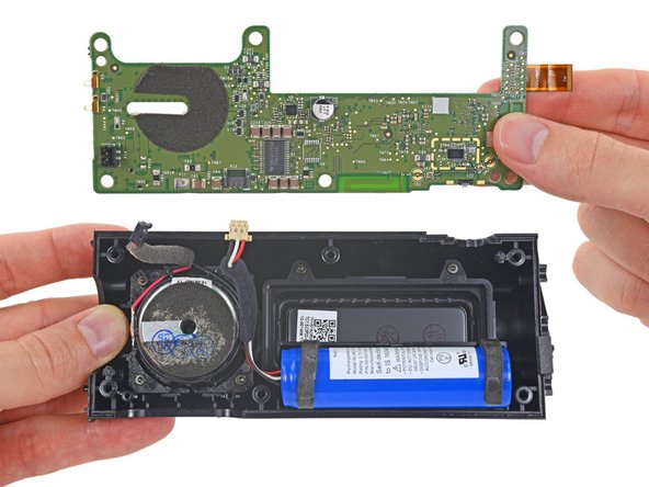

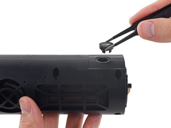

  7. Amazon Tap Teardown: crwdns2935265:07crwdnd2935265:01crwdnd2935265:03crwdne2935265:0 Amazon Tap Teardown: crwdns2935265:07crwdnd2935265:02crwdnd2935265:03crwdne2935265:0 Amazon Tap Teardown: crwdns2935265:07crwdnd2935265:03crwdnd2935265:03crwdne2935265:0
    • With the sheath shucked and a handful of screws dispatched, the Tap falls open like a book.
    • And things are looking up! The I/O panel, mounted by way of a couple screws, attaches to the motherboard via a flex cable and slides right out.
    • That means replacing the USB port, a commonly failing component in mobile devices, will be possible if not totally painless.
    • Moving right along, the motherboard jumps out to join the party.

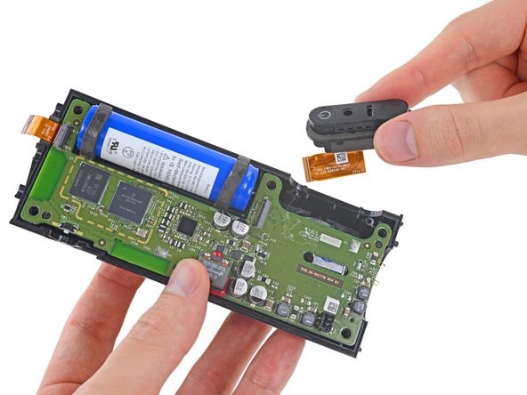

  8. Amazon Tap Teardown: crwdns2935265:08crwdnd2935265:01crwdnd2935265:02crwdne2935265:0 Amazon Tap Teardown: crwdns2935265:08crwdnd2935265:02crwdnd2935265:02crwdne2935265:0

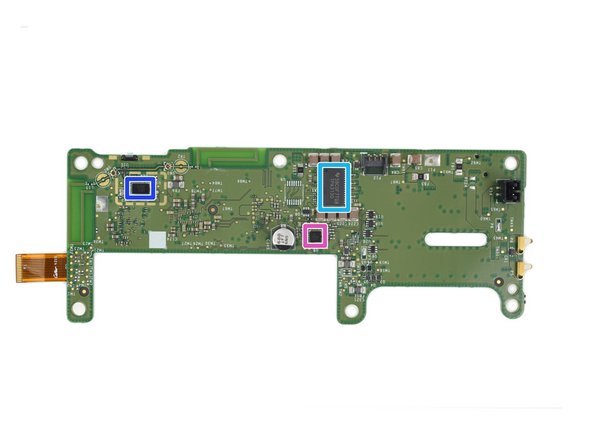

    • Reaching the brains of this smart speaker, we do our due diligence and identify all the key players:
    • Freescale/NXP MCIMX6L8DVN10AB i.MX 6SoloLite Applications Processor
    • Samsung KMNJ2000ZM-B207 512 Mb DDR2 SDRAM Memory (likely)
    • Maxim MAX77697 PMIC
    • Coilcraft SER1360-272L High Current Shielded Power Inductor
    • Texas Instrument TPA3130 15W Filter-Free Class D Stereo Amplifier
    • Broadcom BCM4343 Wi-Fi and Bluetooth 4.2/Bluetooth Smart SoC
    • Maxim MAX98090 Ultra-Low Power Stereo Audio Codec
  9. Amazon Tap Teardown: crwdns2935265:09crwdnd2935265:01crwdnd2935265:02crwdne2935265:0 Amazon Tap Teardown: crwdns2935265:09crwdnd2935265:02crwdnd2935265:02crwdne2935265:0

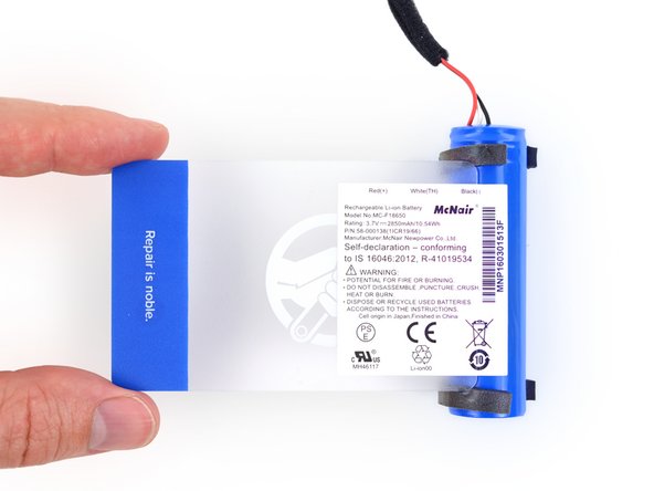

    • Next to come out is a standard 18650 Lithium Ion cell, widely used in the industry from Tesla vehicles to self-balancing boards.
    • This unit is rated for 2850 mAh at 3.7 V to yield 10.54 Wh, which Amazon says will provide up to 9 hours of music playback.
    • Compare that with the 3.8 V, 2750 mAh, 10.45 Wh battery in the iPhone 6s Plus—a battery with a similar output for a radically different job.

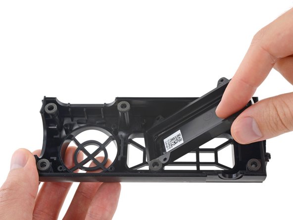

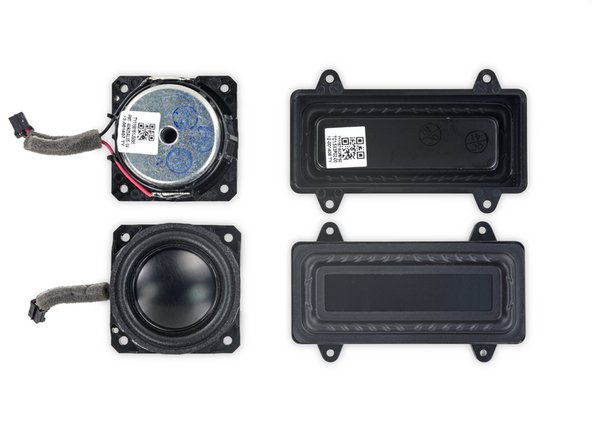

  10. Amazon Tap Teardown: crwdns2935265:010crwdnd2935265:01crwdnd2935265:03crwdne2935265:0 Amazon Tap Teardown: crwdns2935265:010crwdnd2935265:02crwdnd2935265:03crwdne2935265:0 Amazon Tap Teardown: crwdns2935265:010crwdnd2935265:03crwdnd2935265:03crwdne2935265:0
    • We're down to the real heavy hitters: the speakers!
    • These little 1.5-inch drivers each pair with a larger passive radiator to improve lower end frequency response without additional large drivers or a base response tube.
  11. Amazon Tap Teardown: crwdns2935265:011crwdnd2935265:01crwdnd2935265:02crwdne2935265:0 Amazon Tap Teardown: crwdns2935265:011crwdnd2935265:02crwdnd2935265:02crwdne2935265:0
    • Okay but seriously, those passive radiators aren't even connected to anything. How important could they be?
    • We thought you'd never ask. What we have here is a reassembled Tap with a conspicuous absence of passive radiators. So how does it sound?
    • In a word, bad. Just for kicks, we ran a quick audio spectrum test with the passives out, and again with them in. Our puny human test subjects couldn't even hear the signal below 120 Hz—until we reinstalled the passive radiators, at which point they confidently identified a bassy rumble all the way down at ~90 Hz.
    • Good job, passive radiators.
