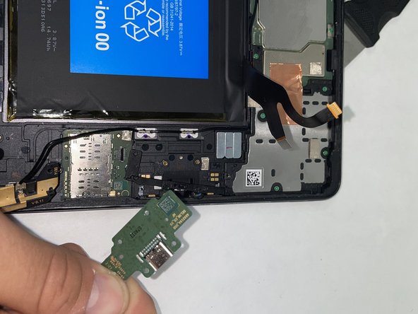

  3. Amazon Fire Max 11 Charging Port Replacement, Charging Port: crwdns2935265:03crwdnd2935265:01crwdnd2935265:01crwdne2935265:0
    • Use a Phillips #00 screwdriver to remove the two screws securing the bracket covering the charging port.
    • Remove the black bracket.
    • Use a spudger or a clean fingernail to flip up the locking flap—this is the unlocked position.
    • Use the widest tool possible to avoid damaging the delicate hinge pins.
    • Once the flap is in the unlocked position, use tweezers or your fingers to gently pull the cable out of its socket by the brown tab.
    • To reconnect, make sure the locking flap is flipped up and gently reinsert the cable. Then, flip the locking flap down to secure the cable. The cable should slide into the socket with little to no force. If you're having trouble, remove it, check that the flap is fully unlocked, and try again.
  4. Amazon Fire Max 11 Charging Port Replacement: crwdns2935265:04crwdnd2935265:01crwdnd2935265:01crwdne2935265:0
    • Use a Phillips #00 screwdriver to remove the remaining two screws from the charging port.
  5. Amazon Fire Max 11 Charging Port Replacement: crwdns2935265:05crwdnd2935265:01crwdnd2935265:02crwdne2935265:0 Amazon Fire Max 11 Charging Port Replacement: crwdns2935265:05crwdnd2935265:02crwdnd2935265:02crwdne2935265:0
    • Lift the charging port up slightly at an angle.
    • Disconnect the cable on the back of the board.
    • Slide the charging port out from the tablet.
