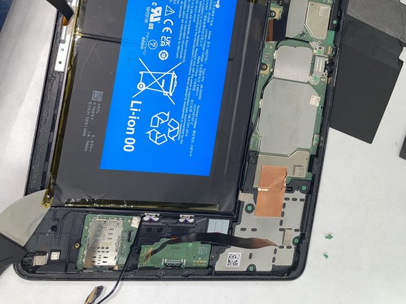

  3. Amazon Fire Max 11 Battery Replacement, Battery: crwdns2935265:03crwdnd2935265:01crwdnd2935265:01crwdne2935265:0
    • Lift up the black flaps protecting the battery from the screen.
    • They have an adhesive surface but can be removed easily.
    • Set them aside as you will put them back once you replace the battery.

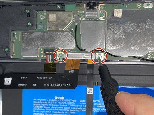

  4. Amazon Fire Max 11 Battery Replacement: crwdns2935265:04crwdnd2935265:01crwdnd2935265:02crwdne2935265:0 Amazon Fire Max 11 Battery Replacement: crwdns2935265:04crwdnd2935265:02crwdnd2935265:02crwdne2935265:0
    • Use a Phillips #000 screwdriver to remove the two screws securing the bracket that connects the motherboard to the magnetic connection port for keyboards through a long, slim wire.
    • Remove the bracket.

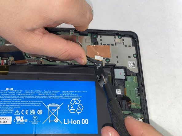

  5. Amazon Fire Max 11 Battery Replacement: crwdns2935265:05crwdnd2935265:01crwdnd2935265:01crwdne2935265:0
    • Place a spudger or an opening tool under the press connector's edge and pry straight up to disconnect it.
    • Make sure to pry under the edge of the connector itself, and not under the socket on the board. Otherwise, you risk permanently damaging the socket.
    • Work carefully: don't pry on or accidentally scrape any small, surface mounted components on the board.
    • To reconnect, align the connector carefully over its socket and press down with your fingertip—first on one side, then the other—until it clicks into place. Don't try to force the connector into place. If you're having trouble, reposition it and try again.
    • Don't press down on the middle of wider connectors until they're fully seated. If misaligned, the connector or the pins underneath can bend or break, causing permanent damage.
  6. Amazon Fire Max 11 Battery Replacement: crwdns2935265:06crwdnd2935265:01crwdnd2935265:02crwdne2935265:0 Amazon Fire Max 11 Battery Replacement: crwdns2935265:06crwdnd2935265:02crwdnd2935265:02crwdne2935265:0
    • Use a Phillips #000 screwdriver to remove the single screw securing the black bracket above the right corner of the battery.
    • Lift the wire up and unplug the connector.
