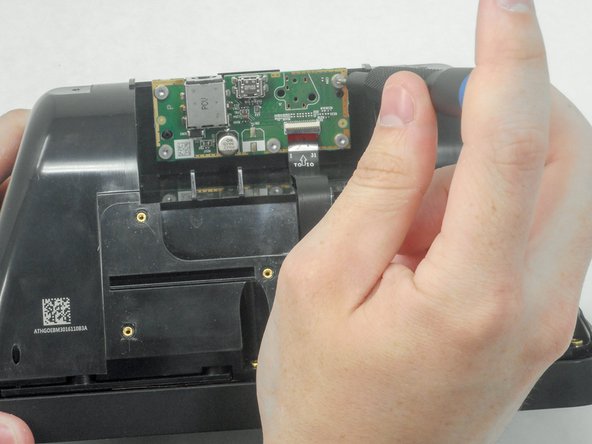

    • Use a T6 Torx screwdriver to remove the four 5.2 mm screws that secure the microphone board to the rear case.

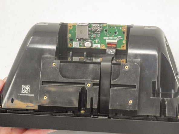

  5. Amazon Echo Show 8 2nd Generation Speaker Replacement, Speaker: crwdns2935265:05crwdnd2935265:01crwdnd2935265:03crwdne2935265:0 Amazon Echo Show 8 2nd Generation Speaker Replacement, Speaker: crwdns2935265:05crwdnd2935265:02crwdnd2935265:03crwdne2935265:0 Amazon Echo Show 8 2nd Generation Speaker Replacement, Speaker: crwdns2935265:05crwdnd2935265:03crwdnd2935265:03crwdne2935265:0

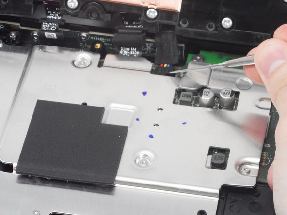

    • Use a T6 Torx screwdriver to remove the five 5.2 mm screws that secure the power board.

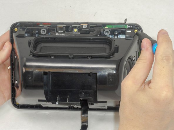

  6. Amazon Echo Show 8 2nd Generation Speaker Replacement: crwdns2935265:06crwdnd2935265:01crwdnd2935265:03crwdne2935265:0 Amazon Echo Show 8 2nd Generation Speaker Replacement: crwdns2935265:06crwdnd2935265:02crwdnd2935265:03crwdne2935265:0 Amazon Echo Show 8 2nd Generation Speaker Replacement: crwdns2935265:06crwdnd2935265:03crwdnd2935265:03crwdne2935265:0

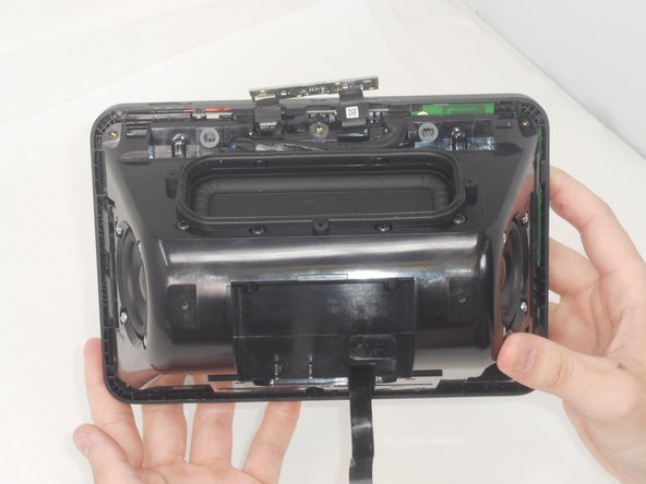

    • Use a T6 Torx screwdriver to remove the six 7.6 mm screws that secure the speaker housing to the display assembly.
    • There is a sixth screw at the bottom between the two outside screws not shown in this image.

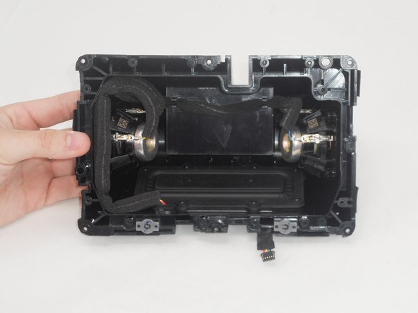

  7. Amazon Echo Show 8 2nd Generation Speaker Replacement: crwdns2935265:07crwdnd2935265:01crwdnd2935265:01crwdne2935265:0
    • Gently separate the speaker housing from the front section like opening a book.
    • Lay the display assembly face down.
    • Take care when separating the two sections to avoid straining or damaging the speaker connector.

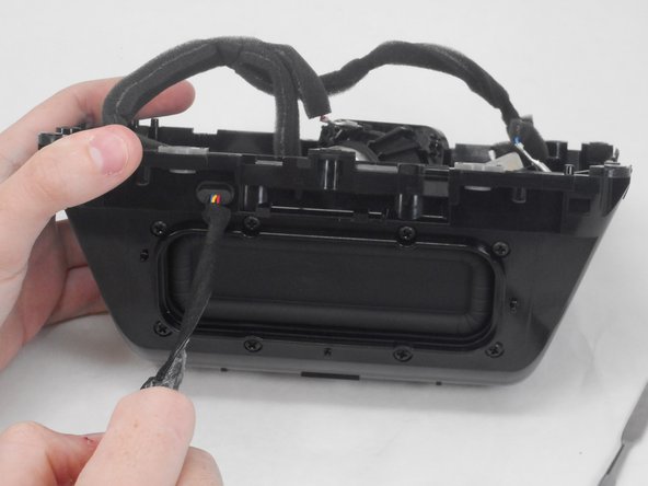

  8. Amazon Echo Show 8 2nd Generation Speaker Replacement: crwdns2935265:08crwdnd2935265:01crwdnd2935265:02crwdne2935265:0 Amazon Echo Show 8 2nd Generation Speaker Replacement: crwdns2935265:08crwdnd2935265:02crwdnd2935265:02crwdne2935265:0
    • Use a spudger to gently push the speaker connector directly out of its port.
    • Make sure not to apply excessive force as doing so will damage the female connector

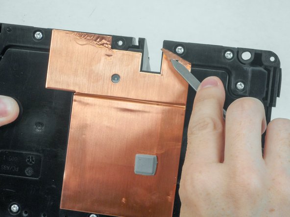

  9. Amazon Echo Show 8 2nd Generation Speaker Replacement: crwdns2935265:09crwdnd2935265:01crwdnd2935265:03crwdne2935265:0 Amazon Echo Show 8 2nd Generation Speaker Replacement: crwdns2935265:09crwdnd2935265:02crwdnd2935265:03crwdne2935265:0 Amazon Echo Show 8 2nd Generation Speaker Replacement: crwdns2935265:09crwdnd2935265:03crwdnd2935265:03crwdne2935265:0

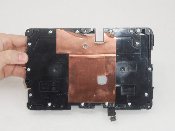

    • Use metal spudger to gently peel back part of the copper heat shield to reveal two 9 mm Phillips screws.

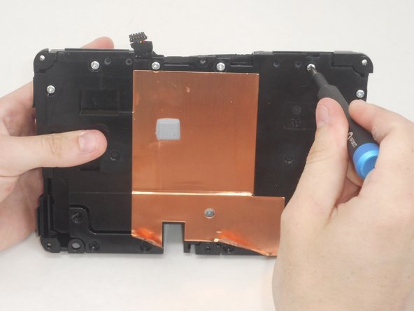

    • Use a Philips screwdriver to remove the fourteen 9 mm screws from the speaker housing cover.
    • Remove the speaker housing cover.

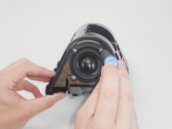

  11. Amazon Echo Show 8 2nd Generation Speaker Replacement: crwdns2935265:011crwdnd2935265:01crwdnd2935265:02crwdne2935265:0 Amazon Echo Show 8 2nd Generation Speaker Replacement: crwdns2935265:011crwdnd2935265:02crwdnd2935265:02crwdne2935265:0

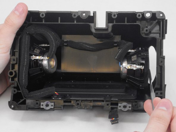

    • Use a Phillips screwdriver to remove the four 9 mm screws that secure the driver.
    • Repeat this step for the driver on the opposite side.
  12. Amazon Echo Show 8 2nd Generation Speaker Replacement: crwdns2935265:012crwdnd2935265:01crwdnd2935265:02crwdne2935265:0 Amazon Echo Show 8 2nd Generation Speaker Replacement: crwdns2935265:012crwdnd2935265:02crwdnd2935265:02crwdne2935265:0
    • Insert a spudger between the driver and the housing and gently pry it away.
    • A considerable amount of force may be required at this step due to the adhesive holding the speaker to the housing.

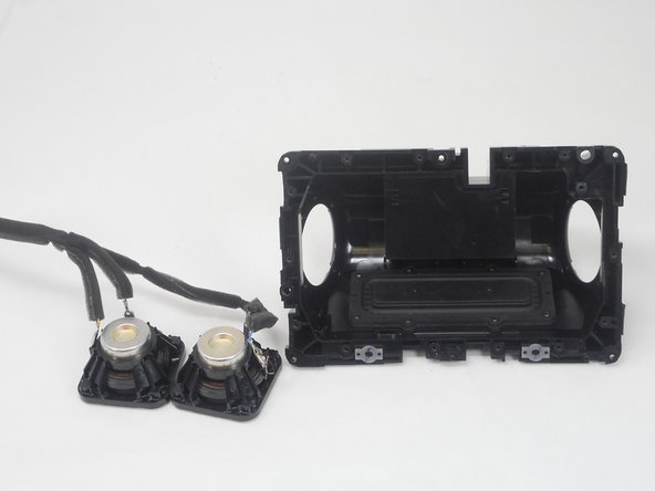

  16. Amazon Echo Show 8 2nd Generation Speaker Replacement: crwdns2935265:016crwdnd2935265:01crwdnd2935265:02crwdne2935265:0 Amazon Echo Show 8 2nd Generation Speaker Replacement: crwdns2935265:016crwdnd2935265:02crwdnd2935265:02crwdne2935265:0
    • Remove the drivers.
