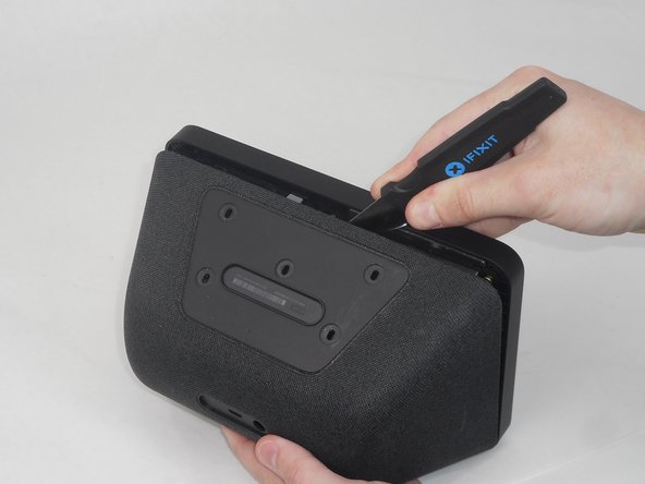

    • Flip the device so that the rubber foot is facing up.
    • Insert a Jimmy between the rubber foot and chassis, then slide it around the perimeter until the rubber foot releases.
    • The adhesive that holds the rubber mat on may require some force to sever.
    • Remove the rubber foot.

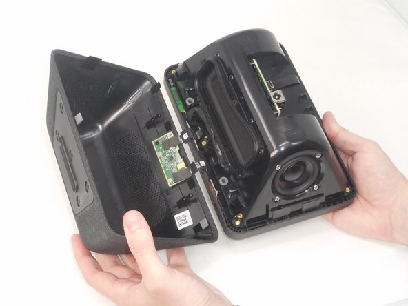

  3. Amazon Echo Show 8 2nd Generation Power Board Replacement: crwdns2935265:03crwdnd2935265:01crwdnd2935265:03crwdne2935265:0 Amazon Echo Show 8 2nd Generation Power Board Replacement: crwdns2935265:03crwdnd2935265:02crwdnd2935265:03crwdne2935265:0 Amazon Echo Show 8 2nd Generation Power Board Replacement: crwdns2935265:03crwdnd2935265:03crwdnd2935265:03crwdne2935265:0
    • Insert a Jimmy in the gap between the front and rear case.
    • Work the Jimmy around the perimeter to gently detach the rear case from the front case.
    • Separate the rear case from the front case.

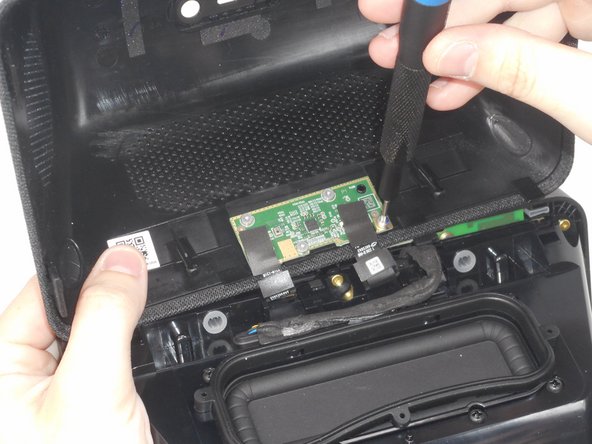

    • There are 2 thin ribbon cables connecting the microphone board to the back cover. Take care not to tear or strain them as you separate the cases.

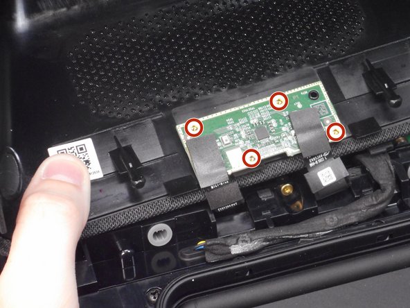

  4. Amazon Echo Show 8 2nd Generation Power Board Replacement: crwdns2935265:04crwdnd2935265:01crwdnd2935265:03crwdne2935265:0 Amazon Echo Show 8 2nd Generation Power Board Replacement: crwdns2935265:04crwdnd2935265:02crwdnd2935265:03crwdne2935265:0 Amazon Echo Show 8 2nd Generation Power Board Replacement: crwdns2935265:04crwdnd2935265:03crwdnd2935265:03crwdne2935265:0
    • Use a T6 Torx screwdriver to remove the four 5.2 mm screws that secure the microphone board to the rear case.

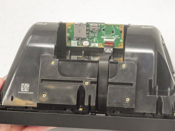

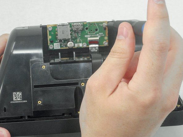

  5. Amazon Echo Show 8 2nd Generation Power Board Replacement, Power Board: crwdns2935265:05crwdnd2935265:01crwdnd2935265:03crwdne2935265:0 Amazon Echo Show 8 2nd Generation Power Board Replacement, Power Board: crwdns2935265:05crwdnd2935265:02crwdnd2935265:03crwdne2935265:0 Amazon Echo Show 8 2nd Generation Power Board Replacement, Power Board: crwdns2935265:05crwdnd2935265:03crwdnd2935265:03crwdne2935265:0
    • Lay the device face down with the power board facing you.
    • Use a T6 Torx screwdriver to remove the five 5.3 mm screws that secure the power board.

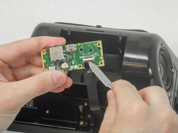

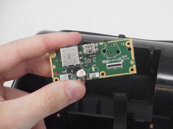

  6. Amazon Echo Show 8 2nd Generation Power Board Replacement: crwdns2935265:06crwdnd2935265:01crwdnd2935265:03crwdne2935265:0 Amazon Echo Show 8 2nd Generation Power Board Replacement: crwdns2935265:06crwdnd2935265:02crwdnd2935265:03crwdne2935265:0 Amazon Echo Show 8 2nd Generation Power Board Replacement: crwdns2935265:06crwdnd2935265:03crwdnd2935265:03crwdne2935265:0
    • Gently lift the power board out from its original position.
    • The ribbon cable is attached with adhesive to the speaker housing. Take care not to tear it when lifting the power board.
    • Use a spudger or your fingernail to flip up the black ZIF locking flap.
    • Pull the ribbon cable directly out of its port.
