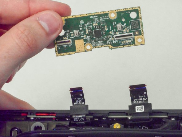

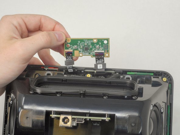

    • Use a T6 Torx screwdriver to remove the four 5.2 mm screws that secure the microphone board to the rear case.
  5. Amazon Echo Show 8 2nd Generation Microphone Board Replacement, Microphone: crwdns2935265:05crwdnd2935265:01crwdnd2935265:03crwdne2935265:0 Amazon Echo Show 8 2nd Generation Microphone Board Replacement, Microphone: crwdns2935265:05crwdnd2935265:02crwdnd2935265:03crwdne2935265:0 Amazon Echo Show 8 2nd Generation Microphone Board Replacement, Microphone: crwdns2935265:05crwdnd2935265:03crwdnd2935265:03crwdne2935265:0

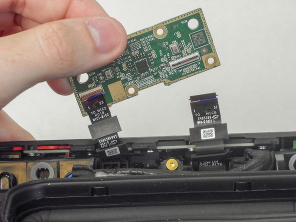

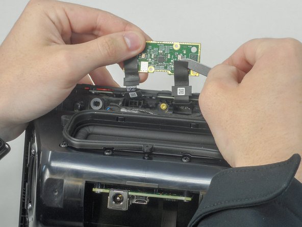

    • Orient the Echo with the microphone board facing upwards.
    • Use a spudger to gently remove the 2 pieces of foam covering the ribbon cables.
  6. Amazon Echo Show 8 2nd Generation Microphone Board Replacement: crwdns2935265:06crwdnd2935265:01crwdnd2935265:03crwdne2935265:0 Amazon Echo Show 8 2nd Generation Microphone Board Replacement: crwdns2935265:06crwdnd2935265:02crwdnd2935265:03crwdne2935265:0 Amazon Echo Show 8 2nd Generation Microphone Board Replacement: crwdns2935265:06crwdnd2935265:03crwdnd2935265:03crwdne2935265:0
    • Use the pointed end of a spudger to flip up both of the ZIF locking flaps.
    • Gently remove both of the ribbon cables from their respective sockets.
    • Lift the micro
