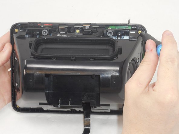

      • Use a T6 Torx screwdriver to remove the four 5.2 mm screws that secure the microphone board to the rear case.

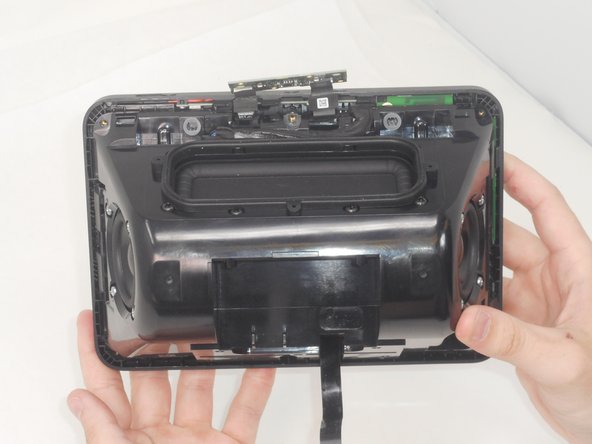

    1. Amazon Echo Show 8 2nd Generation Camera Replacement, Camera: crwdns2935265:05crwdnd2935265:01crwdnd2935265:03crwdne2935265:0 Amazon Echo Show 8 2nd Generation Camera Replacement, Camera: crwdns2935265:05crwdnd2935265:02crwdnd2935265:03crwdne2935265:0 Amazon Echo Show 8 2nd Generation Camera Replacement, Camera: crwdns2935265:05crwdnd2935265:03crwdnd2935265:03crwdne2935265:0
      • Use a T6 Torx screwdriver to remove the six 7.6 mm screws that secure the speaker housing to the screen assembly.
      • There is a screw that is not pictured in the center of the bottom two screws.

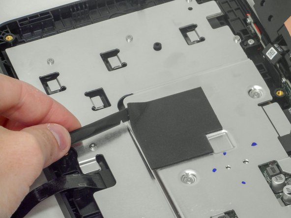

    2. Amazon Echo Show 8 2nd Generation Camera Replacement: crwdns2935265:06crwdnd2935265:01crwdnd2935265:03crwdne2935265:0 Amazon Echo Show 8 2nd Generation Camera Replacement: crwdns2935265:06crwdnd2935265:02crwdnd2935265:03crwdne2935265:0 Amazon Echo Show 8 2nd Generation Camera Replacement: crwdns2935265:06crwdnd2935265:03crwdnd2935265:03crwdne2935265:0

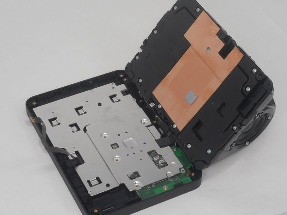

      • Gently separate the speaker housing from the display assembly and set the device on a flat surface.
      • There is a cable connecting the speaker housing to the display assembly. Take care not to pull on it while separating the two parts.

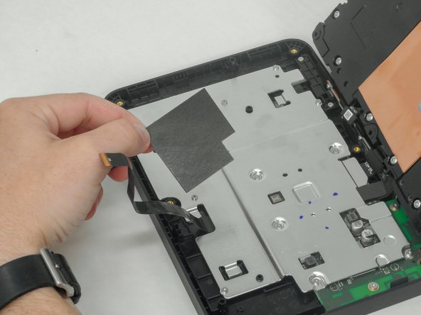

      • Use a plastic spudger to pry up and remove the foam mat at the center of the silver bracket.
    3. Amazon Echo Show 8 2nd Generation Camera Replacement: crwdns2935265:07crwdnd2935265:01crwdnd2935265:02crwdne2935265:0 Amazon Echo Show 8 2nd Generation Camera Replacement: crwdns2935265:07crwdnd2935265:02crwdnd2935265:02crwdne2935265:0
      • Use a T6 Torx screwdriver to remove the eleven 6 mm screws that secure the silver bracket.
    4. Amazon Echo Show 8 2nd Generation Camera Replacement: crwdns2935265:08crwdnd2935265:01crwdnd2935265:03crwdne2935265:0 Amazon Echo Show 8 2nd Generation Camera Replacement: crwdns2935265:08crwdnd2935265:02crwdnd2935265:03crwdne2935265:0 Amazon Echo Show 8 2nd Generation Camera Replacement: crwdns2935265:08crwdnd2935265:03crwdnd2935265:03crwdne2935265:0

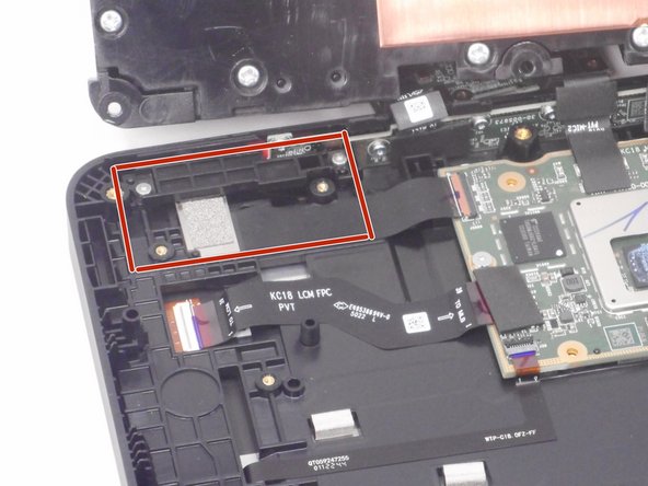

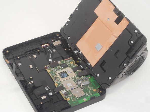

      • Use a plastic spudger to lift up the remove the silver bracket.
      • The camera is located to the left of the mother board.
    5. Amazon Echo Show 8 2nd Generation Camera Replacement: crwdns2935265:09crwdnd2935265:01crwdnd2935265:03crwdne2935265:0 Amazon Echo Show 8 2nd Generation Camera Replacement: crwdns2935265:09crwdnd2935265:02crwdnd2935265:03crwdne2935265:0 Amazon Echo Show 8 2nd Generation Camera Replacement: crwdns2935265:09crwdnd2935265:03crwdnd2935265:03crwdne2935265:0

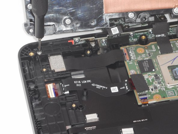

      • Use a T6 Torx screwdriver to remove the two 6 mm screws that secure the camera retention plate.

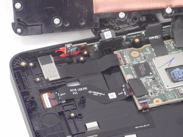

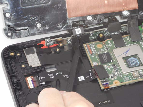

      • Use a spudger to slightly lift the camera retention plate.
      • Lift the camera retention plate up and out of the chassis.

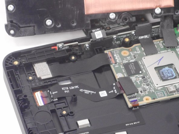

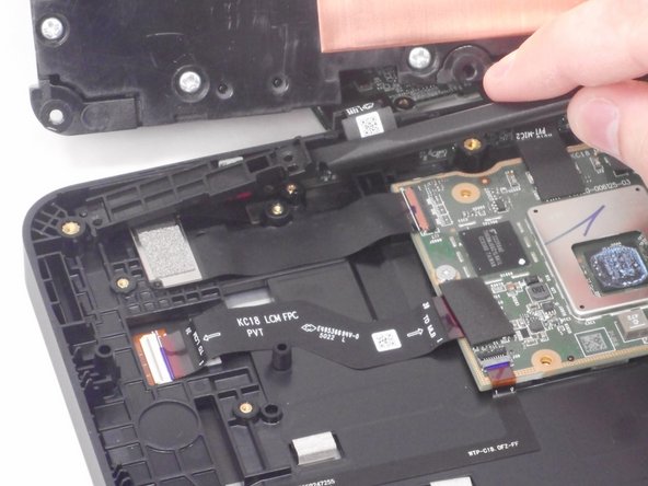

      • Use the pointed end of a spudger to flip up the camera ribbon cable ZIF locking flap.
      • Pull the ribbon cable directly out of its socket.

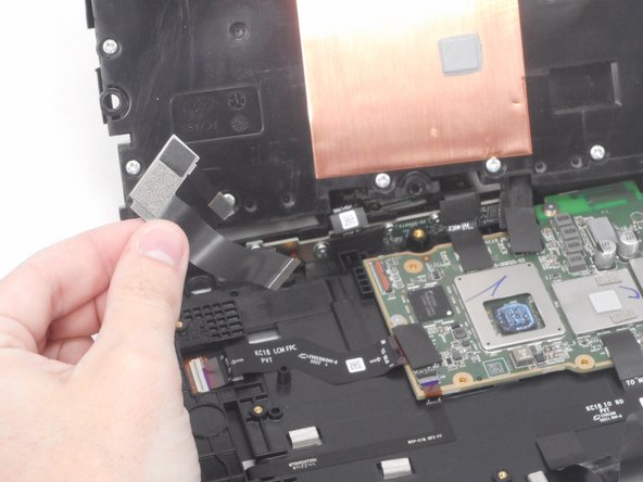

      • Lift up the camera gently, and use the pointed end of the spudger to gently remove the thin black ribbon cable.
      • The thin tab holding is held down with adhesive. Be gentle when removing it to prevent tearing it.
