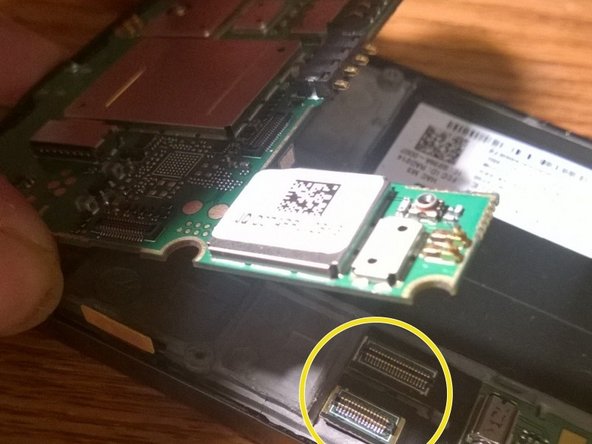

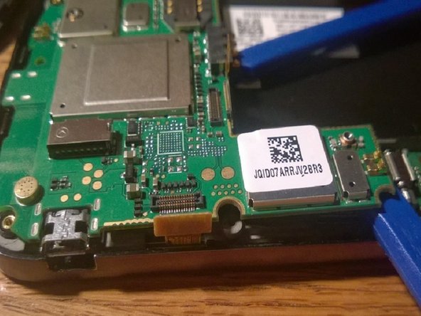

  5. Alcatel One Touch Ultra 995 Teardown: crwdns2935265:05crwdnd2935265:01crwdnd2935265:03crwdne2935265:0 Alcatel One Touch Ultra 995 Teardown: crwdns2935265:05crwdnd2935265:02crwdnd2935265:03crwdne2935265:0 Alcatel One Touch Ultra 995 Teardown: crwdns2935265:05crwdnd2935265:03crwdnd2935265:03crwdne2935265:0
    • Time to remove the logic board. There are no screws to remove here. The logic board is held in place by adhesive.
    • Start at the bottom left corner and insert a flat pry tool and work it in under the logic board to try and release the adhesive.
    • Most of the adhesive is under the bottom left side of the logic board. The flatter your tool the better.
    • work your way around the the area where the battery terminals are and try to get some separation.
    • There are two connections that tie the logic boards together. They should pop loose by sliding a pry tool under the large logic board right next to the vibrator motor (on the small logic board).
    • With the two connections loose, lift up from that location and remove the larger logic board.
    • Its easiest to lift from that area and slide forward while lifting out the larger logic board because otherwise the hdmi port makes it a pain to lift from the bottom side, because the frame goes around the hdmi port.
