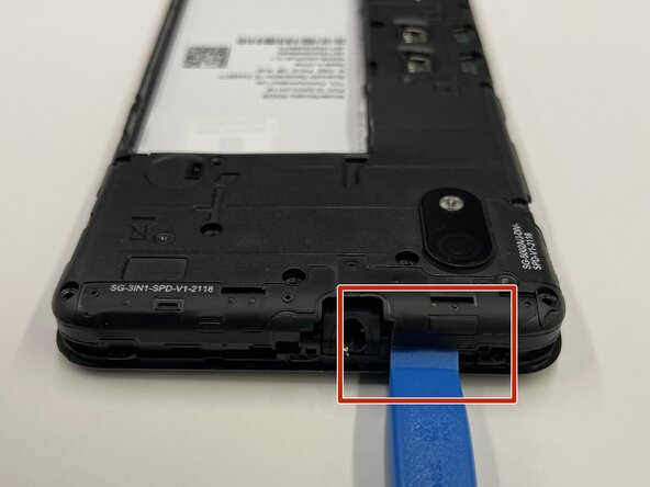

      • Insert the opening tool into the seam between the back plastic case and the front screen.
      • Slide it around the edge of the phone to release the clips holding them together.
      • Remove the bottom case by hand.

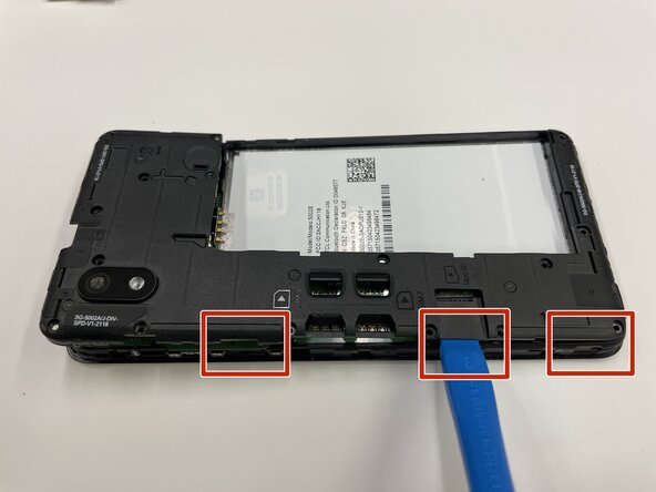

    2. Alcatel 1B 2020 Screen Replacement: crwdns2935265:04crwdnd2935265:01crwdnd2935265:03crwdne2935265:0 Alcatel 1B 2020 Screen Replacement: crwdns2935265:04crwdnd2935265:02crwdnd2935265:03crwdne2935265:0 Alcatel 1B 2020 Screen Replacement: crwdns2935265:04crwdnd2935265:03crwdnd2935265:03crwdne2935265:0
      • Use a plastic opening tool to pry the midframe from the bottom case.
      • Slide the end of the opening tool around the perimeter of the device to release the clips holding the midframe and bottom case together.
      • Be careful, the motherboard is located right beneath the midframe.
      • Remove the midframe from the phone.

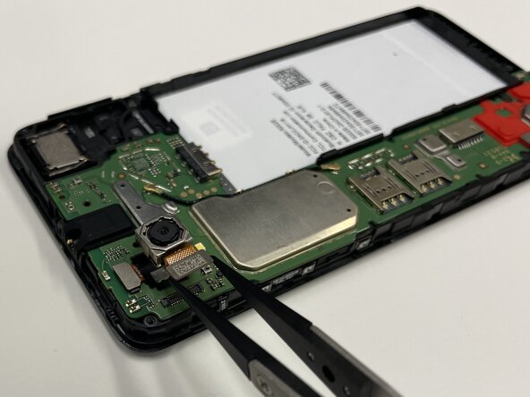

    3. Alcatel 1B 2020 Screen Replacement: crwdns2935265:05crwdnd2935265:01crwdnd2935265:03crwdne2935265:0 Alcatel 1B 2020 Screen Replacement: crwdns2935265:05crwdnd2935265:02crwdnd2935265:03crwdne2935265:0 Alcatel 1B 2020 Screen Replacement: crwdns2935265:05crwdnd2935265:03crwdnd2935265:03crwdne2935265:0
      • Place a spudger or an opening tool under the camera press connector edge and pry straight up to disconnect it.
      • Make sure to pry under the edge of the connector itself, and not under the socket on the board. Otherwise, you risk permanently damaging the socket.
      • Use the tweezers to pull the rear camera out.

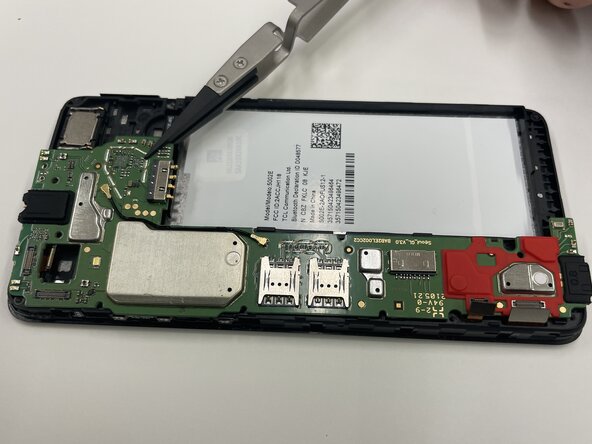

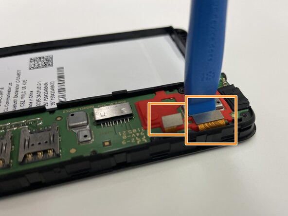

    1. Alcatel 1B 2020 Screen Replacement, Motherboard: crwdns2935265:06crwdnd2935265:01crwdnd2935265:02crwdne2935265:0 Alcatel 1B 2020 Screen Replacement, Motherboard: crwdns2935265:06crwdnd2935265:02crwdnd2935265:02crwdne2935265:0
      • Insert a spudger or opening tool under the edge of the front camera cable connector and pry straight up to disconnect it.
      • Disconnect the other two press connectors near the red part of the motherboard.
    2. Alcatel 1B 2020 Screen Replacement: crwdns2935265:07crwdnd2935265:01crwdnd2935265:03crwdne2935265:0 Alcatel 1B 2020 Screen Replacement: crwdns2935265:07crwdnd2935265:02crwdnd2935265:03crwdne2935265:0 Alcatel 1B 2020 Screen Replacement: crwdns2935265:07crwdnd2935265:03crwdnd2935265:03crwdne2935265:0
      • Use tweezers to remove the motherboard from the phone.
