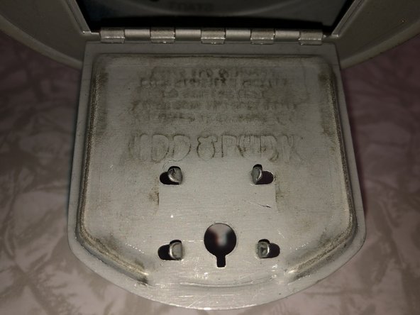

  1. Add-O-Bank Coin Bank Disassembly, Identify the Add O Bank Coin Bank: crwdns2935265:01crwdnd2935265:01crwdnd2935265:01crwdne2935265:0
    • These coin banks were distributed by many banks and insurance companies. The tops were decorated in many colors and with many company logos.
    • In contrast, the bottoms of these coin banks were all the same. Flip the coin bank over. What you see should match the image in this guide step.

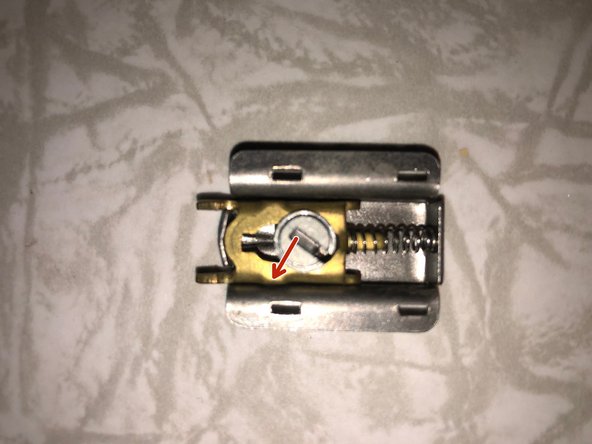

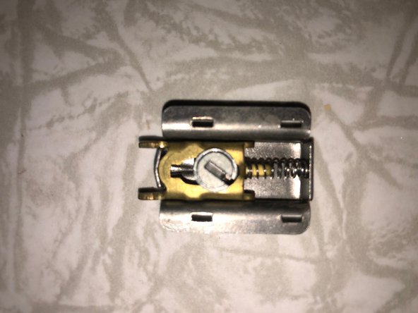

  3. Add-O-Bank Coin Bank Disassembly, Try to Pick the Lock: crwdns2935265:03crwdnd2935265:01crwdnd2935265:03crwdne2935265:0 Add-O-Bank Coin Bank Disassembly, Try to Pick the Lock: crwdns2935265:03crwdnd2935265:02crwdnd2935265:03crwdne2935265:0 Add-O-Bank Coin Bank Disassembly, Try to Pick the Lock: crwdns2935265:03crwdnd2935265:03crwdnd2935265:03crwdne2935265:0
    • Before you continue with this guide, if you're able to pick the lock with a paper clip. Picking the lock should be attempted first, because it will avoid the following step where you damage the lock.
    • Bend the paper clip into an "L" shape and insert it through the key slot. Using the end of the paper clip, feel for one of the two large metal stubs on the sides of the latch mechanism, indicated by the arrow. From the center of the lock cylinder, reach forward a little to engage the stub.
    • Push the latch back far enough to open the door.
    • That the door is not spring-loaded, so you will have to apply pressure with the paper clip while pulling the door open.

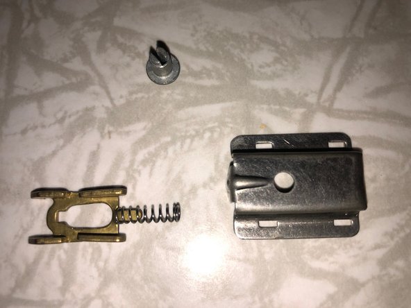

  4. Add-O-Bank Coin Bank Disassembly, Separate the Lock from the Door: crwdns2935265:04crwdnd2935265:01crwdnd2935265:03crwdne2935265:0 Add-O-Bank Coin Bank Disassembly, Separate the Lock from the Door: crwdns2935265:04crwdnd2935265:02crwdnd2935265:03crwdne2935265:0 Add-O-Bank Coin Bank Disassembly, Separate the Lock from the Door: crwdns2935265:04crwdnd2935265:03crwdnd2935265:03crwdne2935265:0
    • If unable to pick the lock as described in the previous step, accessing the bank can be done by separating the lock from the door.
    • To separate the lock from the door, press down firmly on the two indicated shiny pieces of metal showing through the bottom door of the coin bank. The shiny metal is part of the steel base plate of the lock.
    • The lock is held together by four weak metal tabs on the inside, as shown in the second photo. These give way easily when you apply enough pressure. You might not be able to do this if the coin bank is too full of coins.
    • You can get away with bending the tabs open and closed a few times, but eventually metal fatigue will cause the tabs to break off.

  6. Add-O-Bank Coin Bank Disassembly, Reassemble the Lock: crwdns2935265:06crwdnd2935265:01crwdnd2935265:03crwdne2935265:0 Add-O-Bank Coin Bank Disassembly, Reassemble the Lock: crwdns2935265:06crwdnd2935265:02crwdnd2935265:03crwdne2935265:0 Add-O-Bank Coin Bank Disassembly, Reassemble the Lock: crwdns2935265:06crwdnd2935265:03crwdnd2935265:03crwdne2935265:0
    • If unable to pick the lock, it is fairly easy to repair the lock provided that you have not broken off any of the metal tabs inside the bank door.
    • First put the lock mounting plate back onto the tabs. Then put the lock cylinder in place, wide side down.
    • Be mindful of the positions of the lock pieces in the second photo. Flip the mechanism over and place it on top of the door tabs.
    • Before you bend the tabs back into place, look at the Step 7 instructions.

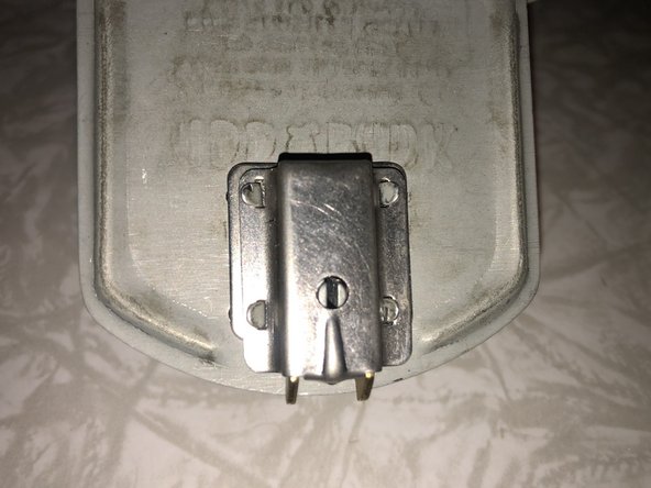

  7. Add-O-Bank Coin Bank Disassembly, Strongly Consider Disabling the Lock: crwdns2935265:07crwdnd2935265:01crwdnd2935265:01crwdne2935265:0
    • If unable to pick the lock with a paper clip, strongly consider disabling the lock.
    • One easy way to do this is to completely remove the sliding latch from the lock, as shown in the photo. Use a piece of strapping tape to hold the door closed.
    • Another way of disabling the lock is to mount the lock mechanism onto the door tabs in the reverse of the correct orientation. This will prevent the teeth of the latch from engaging the metal rim of the coin bank. An advantage of this technique is that the sliding latch piece can't get lost because it stays with the rest of the lock.
    • Once the lock mechanism is back in place, bend down the metal tabs to secure the lock back in place. On the other hand, you may wish to keep the lock only loosely fastened to the door, so that you can easily reopen the coin bank at any time.
