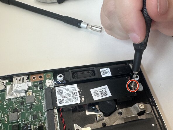

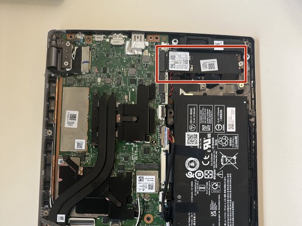

  3. Acer Swift X N20C12 Motherboard Replacement, SSD: crwdns2935265:03crwdnd2935265:01crwdnd2935265:01crwdne2935265:0
    • The SSD is located to the right of the battery.

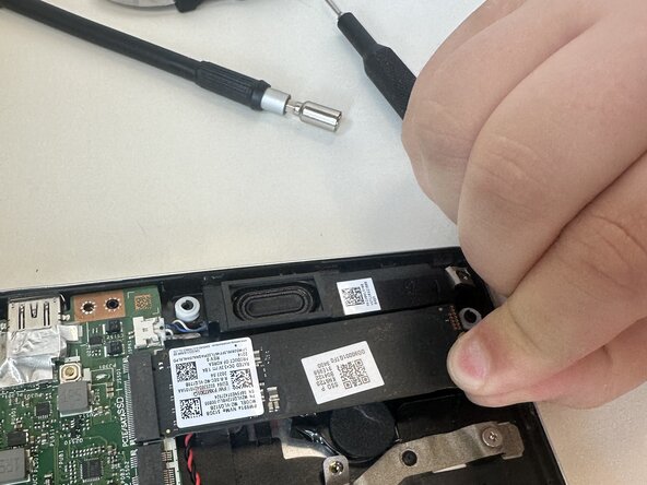

  4. Acer Swift X N20C12 Motherboard Replacement: crwdns2935265:04crwdnd2935265:01crwdnd2935265:01crwdne2935265:0
    • Use a Phillips screwdriver end to remove the 5 mm screw that secures the SSD.
  5. Acer Swift X N20C12 Motherboard Replacement: crwdns2935265:05crwdnd2935265:01crwdnd2935265:01crwdne2935265:0
    • Gently remove the SSD from the computer by pulling it straight out of its motherboard socket.

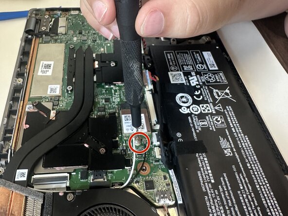

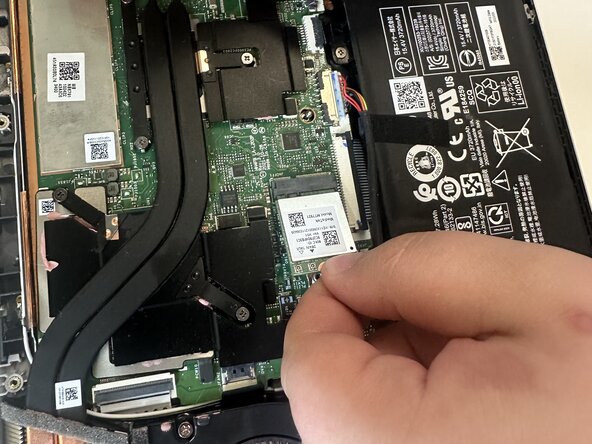

  6. Acer Swift X N20C12 Motherboard Replacement, Wi-Fi Card: crwdns2935265:06crwdnd2935265:01crwdnd2935265:01crwdne2935265:0
    • Use a Phillips screwdriver to remove the 5 mm screw that secures the Wi-Fi card.
  7. Acer Swift X N20C12 Motherboard Replacement: crwdns2935265:07crwdnd2935265:01crwdnd2935265:01crwdne2935265:0
    • Use the pointed end of a spudger to lift and disconnect the two Wi-Fi card antenna cables.
    • When reconnecting the black and white wires, notice the markings that indicate which color wire goes where.
    • Take the Wi-Fi card out by gently pulling it away from the motherboard connector.

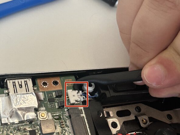

  11. Acer Swift X N20C12 Motherboard Replacement, I/O Board: crwdns2935265:011crwdnd2935265:01crwdnd2935265:01crwdne2935265:0
    • Gently disconnect the white I/O board connector by pulling it directly out of its socket.
    • With this type of connector, "walk" the cable out of its socket with the spudger.

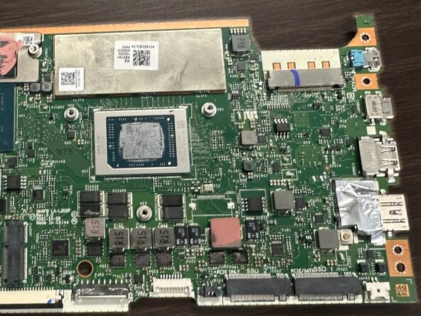

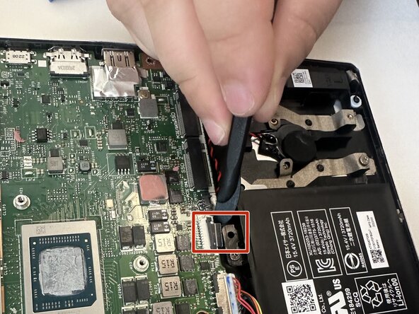

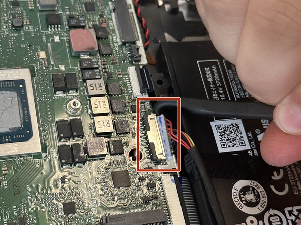

  15. Acer Swift X N20C12 Motherboard Replacement, Motherboard: crwdns2935265:015crwdnd2935265:01crwdnd2935265:01crwdne2935265:0

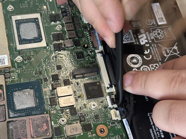

    • Use a spudger to release the black ZIF connector above the battery.
    • Disconnect the ribbon cable.
  16. Acer Swift X N20C12 Motherboard Replacement: crwdns2935265:016crwdnd2935265:01crwdnd2935265:03crwdne2935265:0 Acer Swift X N20C12 Motherboard Replacement: crwdns2935265:016crwdnd2935265:02crwdnd2935265:03crwdne2935265:0 Acer Swift X N20C12 Motherboard Replacement: crwdns2935265:016crwdnd2935265:03crwdnd2935265:03crwdne2935265:0
    • Disconnect the remaining cables from their motherboard sockets.

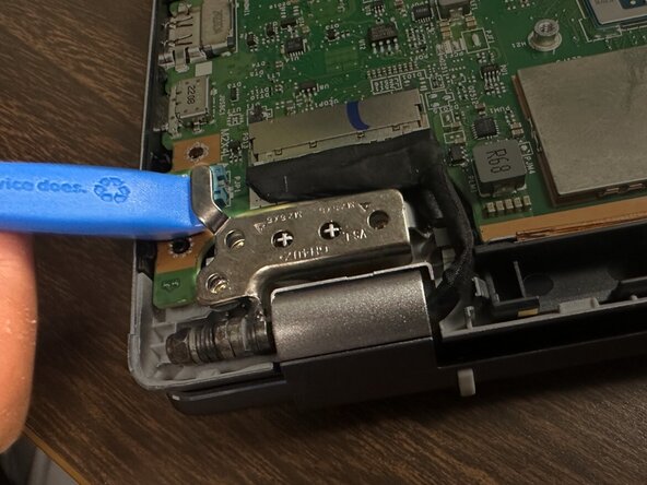

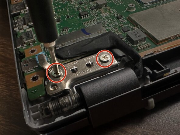

  17. Acer Swift X N20C12 Motherboard Replacement: crwdns2935265:017crwdnd2935265:01crwdnd2935265:02crwdne2935265:0 Acer Swift X N20C12 Motherboard Replacement: crwdns2935265:017crwdnd2935265:02crwdnd2935265:02crwdne2935265:0
    • Remove the 5 mm screws on the two hinges with a Phillips screwdriver.
    • Lift the hinges perpendicular to the motherboard.
  18. Acer Swift X N20C12 Motherboard Replacement: crwdns2935265:018crwdnd2935265:01crwdnd2935265:01crwdne2935265:0
    • Gently lift the motherboard out.
    • You may have to wiggle it slightly since it is enclosed in a tight space.
