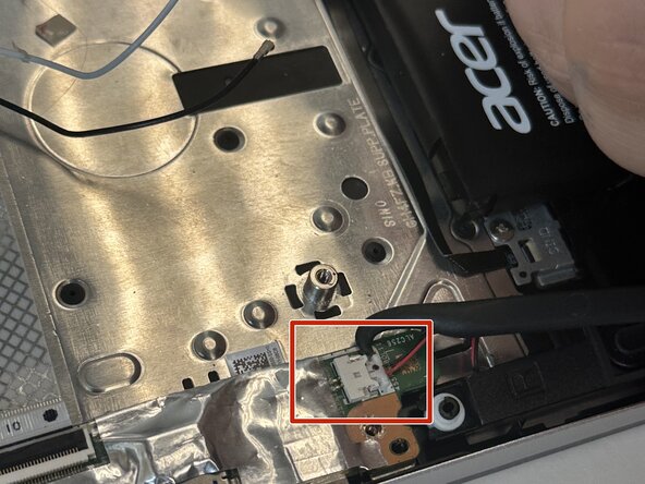

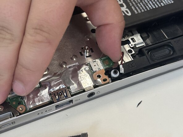

  3. Acer Swift X N20C12 I/O Board Replacement, I/O Board: crwdns2935265:03crwdnd2935265:01crwdnd2935265:01crwdne2935265:0
    • Gently disconnect the white I/O board connector by pulling it directly out of its socket.
    • With this type of connector, "walk" the cable out of its socket with the spudger.

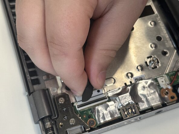

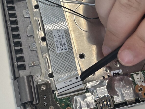

  4. Acer Swift X N20C12 I/O Board Replacement: crwdns2935265:04crwdnd2935265:01crwdnd2935265:02crwdne2935265:0 Acer Swift X N20C12 I/O Board Replacement: crwdns2935265:04crwdnd2935265:02crwdnd2935265:02crwdne2935265:0
    • Use a spudger to flip up the black ZIF locking flap.
    • Disconnect the ribbon cable.

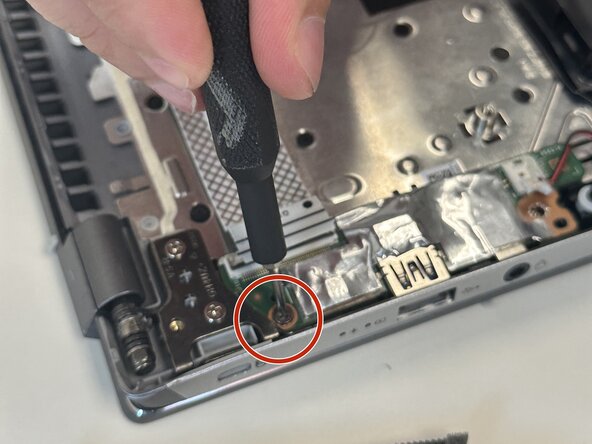

  5. Acer Swift X N20C12 I/O Board Replacement: crwdns2935265:05crwdnd2935265:01crwdnd2935265:01crwdne2935265:0
    • Remove the single 5 mm screw on the I/O board with a Phillips screwdriver.
