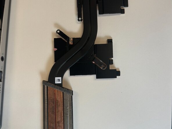

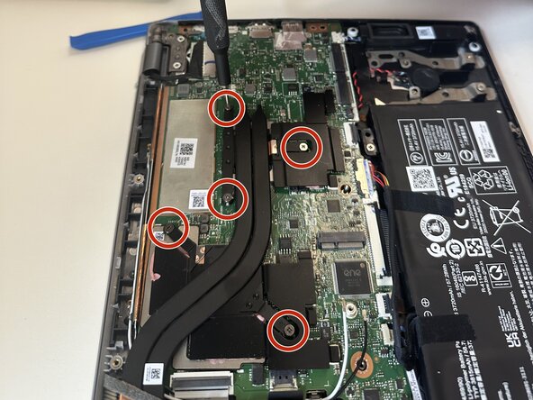

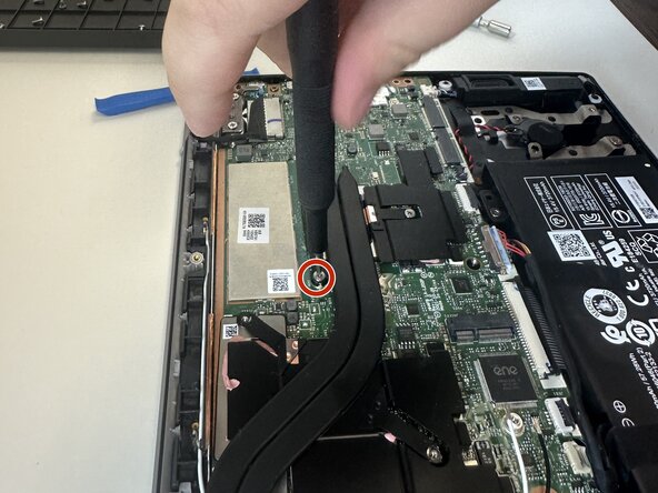

  3. Acer Swift X N20C12 Heatsink Replacement, Heatsink: crwdns2935265:03crwdnd2935265:01crwdnd2935265:02crwdne2935265:0 Acer Swift X N20C12 Heatsink Replacement, Heatsink: crwdns2935265:03crwdnd2935265:02crwdnd2935265:02crwdne2935265:0
    • Use a Phillips #00 screwdriver to remove the five 5 mm screws that secure the heatsink.
    • When reinstalling the heatsink, replace the screws in the numbered order as indicated on the heatsink.

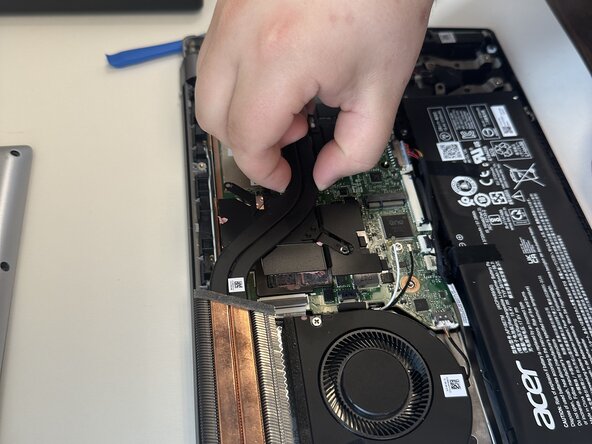

  4. Acer Swift X N20C12 Heatsink Replacement: crwdns2935265:04crwdnd2935265:01crwdnd2935265:01crwdne2935265:0
    • Hold the heatsink firmly with your fingers and lift it straight up to remove it from the laptop.

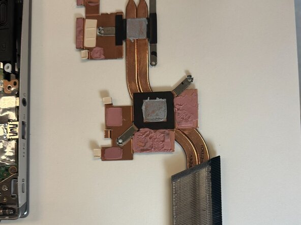

  5. Acer Swift X N20C12 Heatsink Replacement: crwdns2935265:05crwdnd2935265:01crwdnd2935265:02crwdne2935265:0 Acer Swift X N20C12 Heatsink Replacement: crwdns2935265:05crwdnd2935265:02crwdnd2935265:02crwdne2935265:0
    • Lay the heatsink with the thermal paste up so you don't stain your surface.
    • Instead of replacing, if you want to repaste the laptop, clean the thermal paste and pads off of the heatsink and motherboard components with isopropyl alcohol. Follow this guide for more information.
    • When applying the thermal paste/pads on the motherboard components, making sure not to apply too much or little. Do NOT apply the thermal paste/pads on the heatsink.
