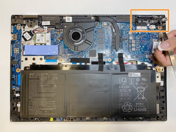

    • Before replacing the charging port, unplug the internal battery from the motherboard.
    • Unplug the broken charging port from the motherboard with tweezers.
  4. Acer Spin SP513-52N Charging Port Replacement: crwdns2935265:04crwdnd2935265:01crwdnd2935265:01crwdne2935265:0
  5. Acer Spin SP513-52N Charging Port Replacement: crwdns2935265:05crwdnd2935265:01crwdnd2935265:02crwdne2935265:0 Acer Spin SP513-52N Charging Port Replacement: crwdns2935265:05crwdnd2935265:02crwdnd2935265:02crwdne2935265:0
    • Use tweezers to insert the new charging port securely.
