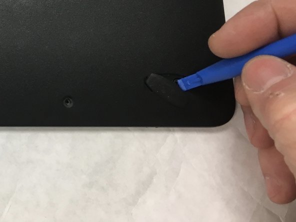

    • Turn over the keyboard and use the plastic opening tool to remove the two adhesive backed rubber pads furthest from the hinge.

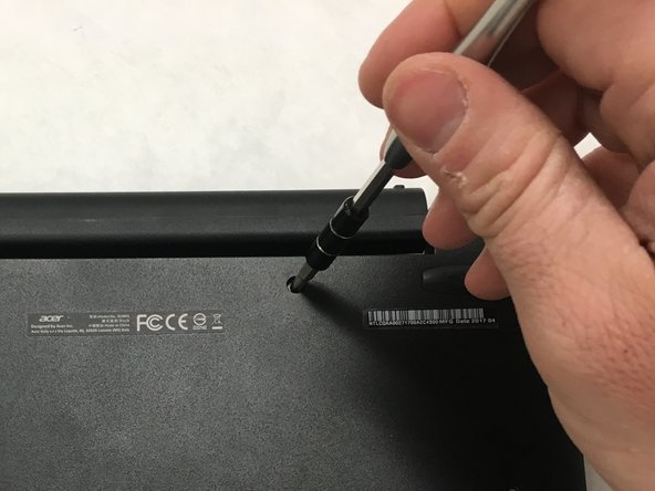

    • Remove the ten total screws from the back cover with a Phillips #1 screwdriver.
    • 8 screws 4.25mm in length with 4.00mm diameter heads.
    • 2 screws 6.00mm in length with 4.00mm diameter heads.

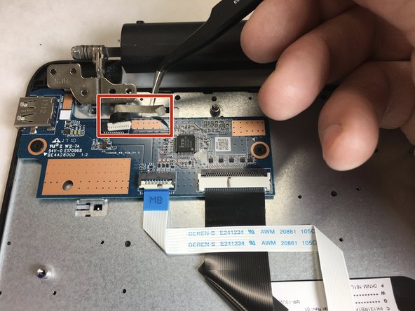

    • Use a pair of tweezers to remove the electrical connector for the hinge. Pull gently while wiggling the connector back and forth.
    • Remove the adhesive tape holding the wire down.

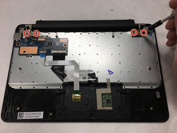

    • To free the hinge, remove the 4 mount screws with a Phillips #0 screwdriver.
