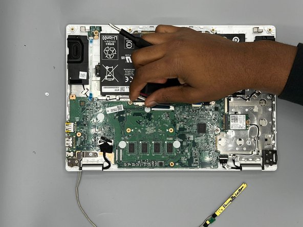

  3. Acer Chromebook R 11 CB5-132T-C9KK Battery Replacement: crwdns2935265:03crwdnd2935265:01crwdnd2935265:02crwdne2935265:0 Acer Chromebook R 11 CB5-132T-C9KK Battery Replacement: crwdns2935265:03crwdnd2935265:02crwdnd2935265:02crwdne2935265:0
    • Use the tip of a spudger or your fingernail to flip up the small locking flap. Then, you can safely pull the cable out to disconnect the battery from the motherboard.

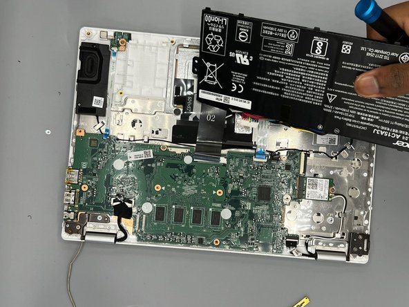

  4. Acer Chromebook R 11 CB5-132T-C9KK Battery Replacement: crwdns2935265:04crwdnd2935265:01crwdnd2935265:02crwdne2935265:0 Acer Chromebook R 11 CB5-132T-C9KK Battery Replacement: crwdns2935265:04crwdnd2935265:02crwdnd2935265:02crwdne2935265:0
    • Remove the battery from the Chromebook.
