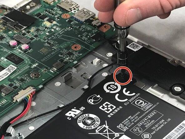

    • Using a Phillips #0 screwdriver, unscrew the screw on right side of the battery placement.
    • Be careful not to lose the screw and have a small container nearby to place it in.

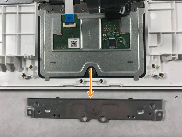

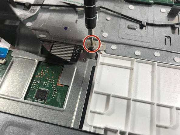

    • Using a Phillips #0 screwdriver, remove the 7 screws holding the trackpad in place.
    • The metal piece at the bottom edge of the laptop will lift off after the screws are removed.

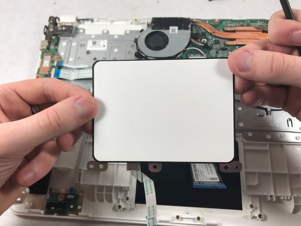

    • Use the spudger tool to pry the trackpad up and away from the laptop.

How do I remove the touchpad from the backing/bracket? The replacement touchpad I bought has none of the metal bracket, and I believe I need to remove it from my old broken one.
Shawn H - crwdns2934203:0crwdne2934203:0
For the record I ended up having to purchase a new mounting bracket separately and affix it ($5). Hope this helps someone. I’ve done the repair but the trackpad is still not functioning. Not sure what the issue is but the swap was pretty easy.
