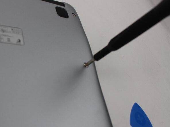

  2. Acer Chromebook CB315-4H-P8FZ Motherboard Replacement: crwdns2935265:02crwdnd2935265:01crwdnd2935265:03crwdne2935265:0 Acer Chromebook CB315-4H-P8FZ Motherboard Replacement: crwdns2935265:02crwdnd2935265:02crwdnd2935265:03crwdne2935265:0 Acer Chromebook CB315-4H-P8FZ Motherboard Replacement: crwdns2935265:02crwdnd2935265:03crwdnd2935265:03crwdne2935265:0
    • Remove the ten 6 mm Phillips screws that secure the lower case.

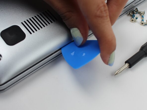

    • Insert an opening pick in the seam between the lower case and chassis.
    • Slide the opening pick around the perimeter of the device, prying every couple of centimeters, until the lower case fully releases.
    • Remove the lower case.

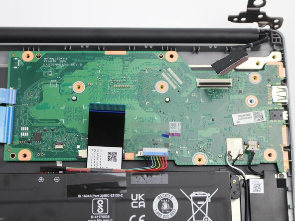

  3. Acer Chromebook CB315-4H-P8FZ Motherboard Replacement, Motherboard: crwdns2935265:03crwdnd2935265:01crwdnd2935265:01crwdne2935265:0
    • Peel back the black tape over the battery connector. Use your fingernails to disconnect the battery connector from its motherboard socket.
    • Peel back the black tape over the ribbon cable to the left of the battery connector. Release the black locking tabs that secure the ribbon cable. Disconnect the ribbon cable.
    • Flip up the two black ZIF locking flaps that secure the two I/O board's motherboard ribbon cable connectors. Disconnect the two ribbon cables.
    • Flip up the black ZIF locking flap that secures the touchpad ribbon cable. Disconnect the touchpad ribbon cable.
    • Use the pointed edge of a spudger to lift and disconnect the two wireless card coaxial connectors.
    • Use your fingernails to disconnect the white speaker connector from its motherboard socket.
    • Flip up the black ZIF locking flap that secures the display cable. Disconnect the display cable.

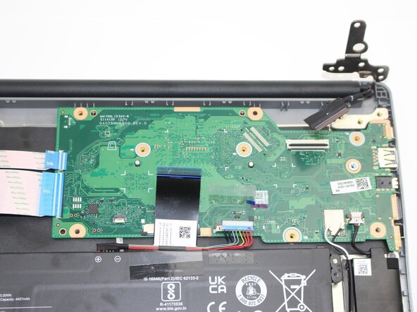

  4. Acer Chromebook CB315-4H-P8FZ Motherboard Replacement: crwdns2935265:04crwdnd2935265:01crwdnd2935265:02crwdne2935265:0 Acer Chromebook CB315-4H-P8FZ Motherboard Replacement: crwdns2935265:04crwdnd2935265:02crwdnd2935265:02crwdne2935265:0
    • Use a Phillips screwdriver to remove the seven Phillips screws that secure the motherboard.
    • Lift up the right hinge.
  5. Acer Chromebook CB315-4H-P8FZ Motherboard Replacement: crwdns2935265:05crwdnd2935265:01crwdnd2935265:02crwdne2935265:0 Acer Chromebook CB315-4H-P8FZ Motherboard Replacement: crwdns2935265:05crwdnd2935265:02crwdnd2935265:02crwdne2935265:0
    • Grip the left edge of the motherboard and gently pull it a couple of millimeters to the left to unseat the ports from the chassis.
    • Lift the motherboard up and out of the chassis.
