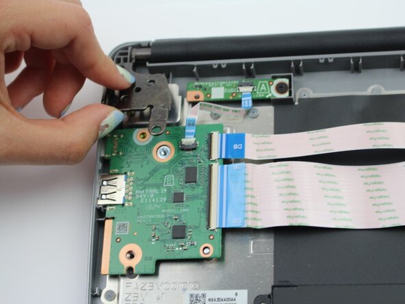

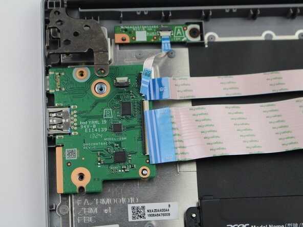

  3. Acer Chromebook CB315-4H-P8FZ I/O Board Replacement, I/O Board: crwdns2935265:03crwdnd2935265:01crwdnd2935265:02crwdne2935265:0 Acer Chromebook CB315-4H-P8FZ I/O Board Replacement, I/O Board: crwdns2935265:03crwdnd2935265:02crwdnd2935265:02crwdne2935265:0
    • Remove the four Phillips screws that secure the I/O board to the chassis and hinge.
    • Flip up the two black ZIF locking flaps. Disconnect the two ribbon cables.
    • Grip the right side of the I/O board and pull it a few millimeters to the right to unseat the ports from the chassis.
    • Lift the I/O board up and out.

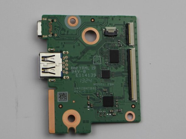

  4. Acer Chromebook CB315-4H-P8FZ I/O Board Replacement: crwdns2935265:04crwdnd2935265:01crwdnd2935265:03crwdne2935265:0 Acer Chromebook CB315-4H-P8FZ I/O Board Replacement: crwdns2935265:04crwdnd2935265:02crwdnd2935265:03crwdne2935265:0 Acer Chromebook CB315-4H-P8FZ I/O Board Replacement: crwdns2935265:04crwdnd2935265:03crwdnd2935265:03crwdne2935265:0
    • Place the new USB-C I/O board into position on the motherboard. (Time: 30 seconds)
    • Reconnect all cables to the new I/O board by gently pressing them into their ports. (Time: 1–2 minutes)
    • Secure the I/O board with screws using a #1 Phillips screwdriver. (Time: 1–2 minutes)
    • Align and place the back cover onto the Chromebook to prepare for reassembly. (Time: 30 seconds)
    • Power on the Chromebook by pressing the power button. (Time: 30 seconds)
    • Plug a device into the new USB-C port to test for proper functionality. (Time: 1 minute)
