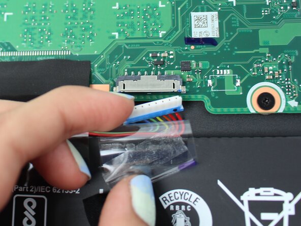

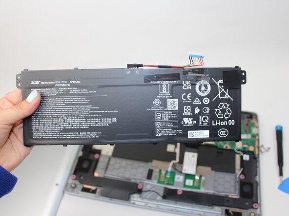

  3. Acer Chromebook CB315-4H-P8FZ Battery Replacement, Battery: crwdns2935265:03crwdnd2935265:01crwdnd2935265:03crwdne2935265:0 Acer Chromebook CB315-4H-P8FZ Battery Replacement, Battery: crwdns2935265:03crwdnd2935265:02crwdnd2935265:03crwdne2935265:0 Acer Chromebook CB315-4H-P8FZ Battery Replacement, Battery: crwdns2935265:03crwdnd2935265:03crwdnd2935265:03crwdne2935265:0
    • Carefully life up the clear tape, then the black tape covering the battery connector.
    • Use your fingernails to gently "walk" the battery connector out of its motherboard socket.
    • Lift the battery up and out of the chassis.
For optimal performance, after completing this guide, calibrate your newly installed battery.
