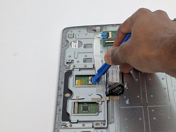

    • Gently slide the plastic opening tool under the black clip that is attached to the ribbon cable.
    • Pull down on the plastic opening tool like a lever to flip the black clip and remove the ribbon cable.
    • The black clip doesn't take much force to lift, so be gentle to avoid breaking it.

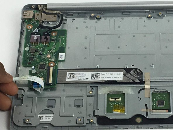

  4. Acer Aspire Switch 10 SW5-011-18R3 Track pad Replacement: crwdns2935265:04crwdnd2935265:01crwdnd2935265:01crwdne2935265:0
    • Remove the touchpad.
