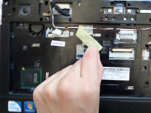

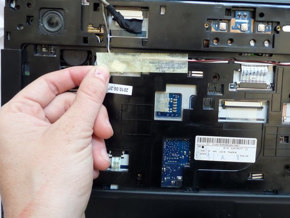

  9. Acer Aspire 5734z-4836 Speaker Replacement: crwdns2935265:09crwdnd2935265:01crwdnd2935265:03crwdne2935265:0 Acer Aspire 5734z-4836 Speaker Replacement: crwdns2935265:09crwdnd2935265:02crwdnd2935265:03crwdne2935265:0 Acer Aspire 5734z-4836 Speaker Replacement: crwdns2935265:09crwdnd2935265:03crwdnd2935265:03crwdne2935265:0
    • Locate the tape on the upper left of the laptop.
    • Peel off the tape, covering the red-and-black wire connector and the white-and-black speaker wires.
  10. Acer Aspire 5734z-4836 Speaker Replacement: crwdns2935265:010crwdnd2935265:01crwdnd2935265:02crwdne2935265:0 Acer Aspire 5734z-4836 Speaker Replacement: crwdns2935265:010crwdnd2935265:02crwdnd2935265:02crwdne2935265:0
    • Gently disconnect the red-and-black wire connector and the white-and-black speaker wires from the upper-left.

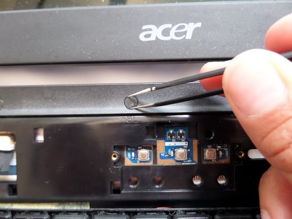

  15. Acer Aspire 5734z-4836 Speaker Replacement: crwdns2935265:015crwdnd2935265:01crwdnd2935265:02crwdne2935265:0 Acer Aspire 5734z-4836 Speaker Replacement: crwdns2935265:015crwdnd2935265:02crwdnd2935265:02crwdne2935265:0
    • Peel away the sticky plastic coverings with tweezers.

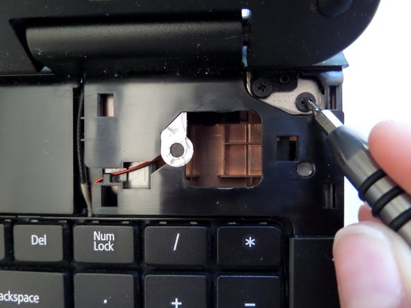

    • Remove the three screws with a #00 Philips Screwdriver.
  17. Acer Aspire 5734z-4836 Speaker Replacement: crwdns2935265:017crwdnd2935265:01crwdnd2935265:01crwdne2935265:0
    • Remove the single screw next to the right hinge with a #00 Phillips Screwdriver.

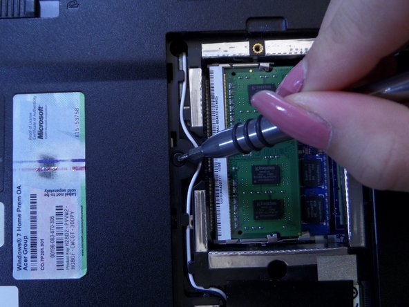

    • Remove the fifteen screws from the back of the laptop with a Phillips #00 Screwdriver.
  20. Acer Aspire 5734z-4836 Speaker Replacement: crwdns2935265:020crwdnd2935265:01crwdnd2935265:02crwdne2935265:0 Acer Aspire 5734z-4836 Speaker Replacement: crwdns2935265:020crwdnd2935265:02crwdnd2935265:02crwdne2935265:0
    • Pry mid-back panel off.
    • Use a plastic opening tool.

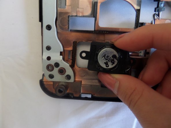

  31. Acer Aspire 5734z-4836 Speaker Replacement, Speaker: crwdns2935265:031crwdnd2935265:01crwdnd2935265:01crwdne2935265:0
    • Begin with the front panel flipped so the speaker is facing you.
    • Locate speaker on the lower left corner of the laptop.
  32. Acer Aspire 5734z-4836 Speaker Replacement: crwdns2935265:032crwdnd2935265:01crwdnd2935265:01crwdne2935265:0
    • Using a Phillips #00 screwdriver, remove one 2.5 mm screw to loosen the speaker from the panel.
  33. Acer Aspire 5734z-4836 Speaker Replacement: crwdns2935265:033crwdnd2935265:01crwdnd2935265:02crwdne2935265:0 Acer Aspire 5734z-4836 Speaker Replacement: crwdns2935265:033crwdnd2935265:02crwdnd2935265:02crwdne2935265:0
    • Grasp the speaker by the sides and slide right.
  34. Acer Aspire 5734z-4836 Speaker Replacement: crwdns2935265:034crwdnd2935265:01crwdnd2935265:01crwdne2935265:0
    • Remove the speaker carefully, extracting the wires from board.
