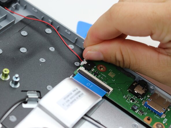

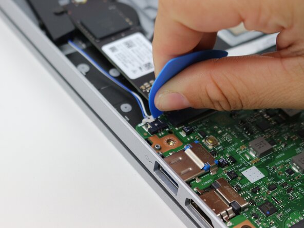

  5. Acer Aspire 3 A315-24PT-R288 Speakers Replacement, Speakers: crwdns2935265:05crwdnd2935265:01crwdnd2935265:03crwdne2935265:0 Acer Aspire 3 A315-24PT-R288 Speakers Replacement, Speakers: crwdns2935265:05crwdnd2935265:02crwdnd2935265:03crwdne2935265:0 Acer Aspire 3 A315-24PT-R288 Speakers Replacement, Speakers: crwdns2935265:05crwdnd2935265:03crwdnd2935265:03crwdne2935265:0
    • Use an opening pick or your fingernails to gently push each of the two speaker connectors out of their sockets.
  6. Acer Aspire 3 A315-24PT-R288 Speakers Replacement: crwdns2935265:06crwdnd2935265:01crwdnd2935265:01crwdne2935265:0
    • Lift both of the speakers up and out the chassis.
