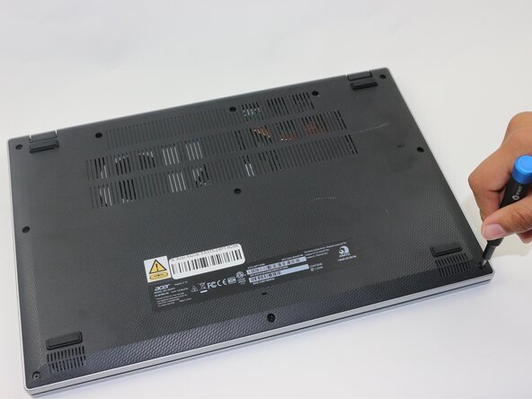

    • For your safety, unplug all peripheries, discharge the battery below 25%, and power down your device before beginning disassembly.
    • Use a Phillips screwdriver to remove the eleven 2 mm screws that secure the lower case.

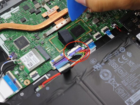

  3. Acer Aspire 3 A315-24PT-R288 Screen Replacement, Acer Aspire 3 A315-24PT-R288 Battery Disconnection: crwdns2935265:03crwdnd2935265:01crwdnd2935265:01crwdne2935265:0
    • Remove the tape on the battery connector using tweezers or your fingers.
  4. Acer Aspire 3 A315-24PT-R288 Screen Replacement: crwdns2935265:04crwdnd2935265:01crwdnd2935265:02crwdne2935265:0 Acer Aspire 3 A315-24PT-R288 Screen Replacement: crwdns2935265:04crwdnd2935265:02crwdnd2935265:02crwdne2935265:0
    • Use an opening pick or the flat end of a spudger to gently push the battery connector out of its motherboard socket.

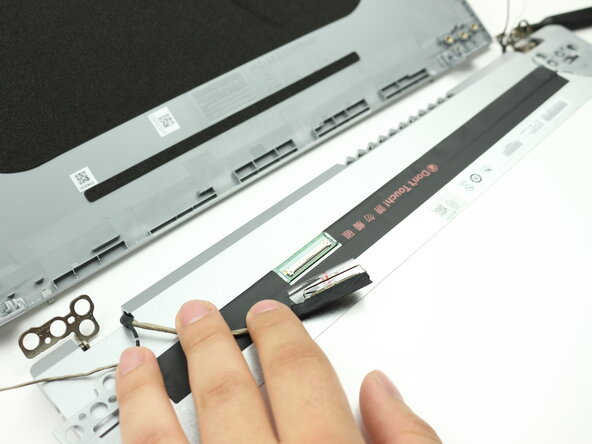

  11. Acer Aspire 3 A315-24PT-R288 Screen Replacement: crwdns2935265:011crwdnd2935265:01crwdnd2935265:02crwdne2935265:0 Acer Aspire 3 A315-24PT-R288 Screen Replacement: crwdns2935265:011crwdnd2935265:02crwdnd2935265:02crwdne2935265:0
    • Lay down the screen flat with the back facing you.
    • Flip up the display connector locking bar.
    • Pull the display connector directly out of its socket.
    • Remove the screen.
