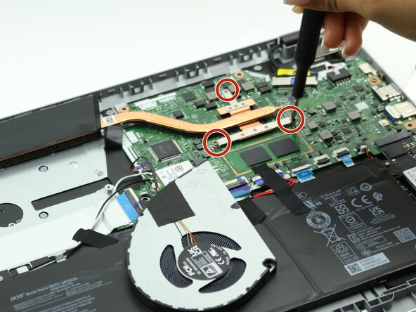

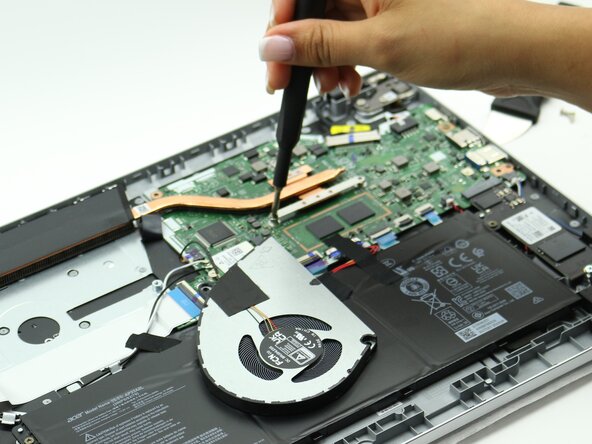

  5. Acer Aspire 3 A315-24PT-R288 Heat Sink Replacement, Heat Sink: crwdns2935265:05crwdnd2935265:01crwdnd2935265:03crwdne2935265:0 Acer Aspire 3 A315-24PT-R288 Heat Sink Replacement, Heat Sink: crwdns2935265:05crwdnd2935265:02crwdnd2935265:03crwdne2935265:0 Acer Aspire 3 A315-24PT-R288 Heat Sink Replacement, Heat Sink: crwdns2935265:05crwdnd2935265:03crwdnd2935265:03crwdne2935265:0
    • Despite the images, it's not necessary to remove the fan prior to removing the heat sink.
    • Remove the three 2mm Phillips #1 screws from the heat sink.
    • When installing your new heat sink, be sure to fasten the screws in the numerical order stamped on the heatsink bracket.

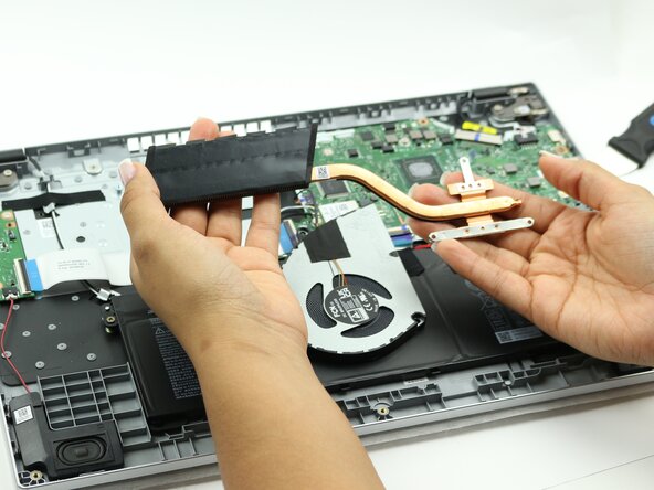

  6. Acer Aspire 3 A315-24PT-R288 Heat Sink Replacement: crwdns2935265:06crwdnd2935265:01crwdnd2935265:02crwdne2935265:0 Acer Aspire 3 A315-24PT-R288 Heat Sink Replacement: crwdns2935265:06crwdnd2935265:02crwdnd2935265:02crwdne2935265:0
    • Lift the heat sink up and out of the chassis.
