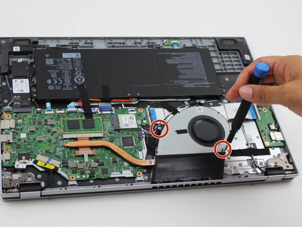

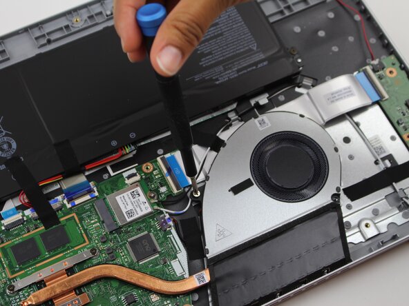

  5. Acer Aspire 3 A315-24PT-R288 Fan Replacement, Fan: crwdns2935265:05crwdnd2935265:01crwdnd2935265:03crwdne2935265:0 Acer Aspire 3 A315-24PT-R288 Fan Replacement, Fan: crwdns2935265:05crwdnd2935265:02crwdnd2935265:03crwdne2935265:0 Acer Aspire 3 A315-24PT-R288 Fan Replacement, Fan: crwdns2935265:05crwdnd2935265:03crwdnd2935265:03crwdne2935265:0
    • Remove the two 2 mm Phillips screws that secure the fan.

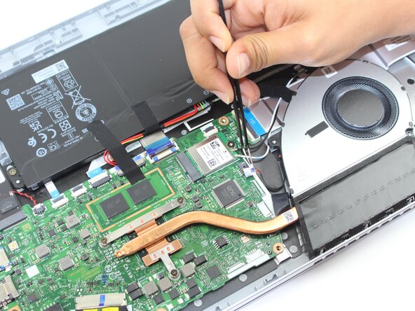

  6. Acer Aspire 3 A315-24PT-R288 Fan Replacement: crwdns2935265:06crwdnd2935265:01crwdnd2935265:03crwdne2935265:0 Acer Aspire 3 A315-24PT-R288 Fan Replacement: crwdns2935265:06crwdnd2935265:02crwdnd2935265:03crwdne2935265:0 Acer Aspire 3 A315-24PT-R288 Fan Replacement: crwdns2935265:06crwdnd2935265:03crwdnd2935265:03crwdne2935265:0
    • Remove the black tape that secures the fan cable.
    • Use tweezers remove the white fan connector from its socket.
    • Alternatively, use your fingernails or the flat end of a spudger to gently push the connector out of its socket.

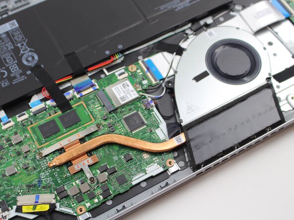

  7. Acer Aspire 3 A315-24PT-R288 Fan Replacement: crwdns2935265:07crwdnd2935265:01crwdnd2935265:01crwdne2935265:0
    • Lift the fan up and out of the chassis.
